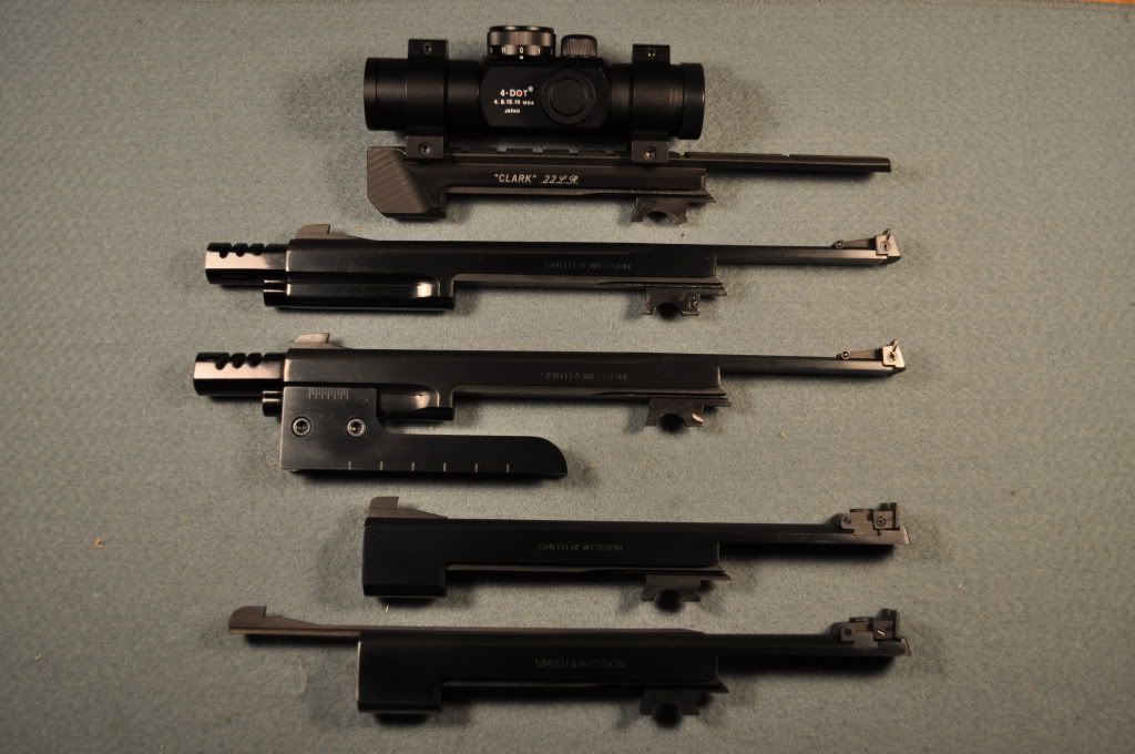

Accessories included different barrels, internal and external weight sets to target shooting, checkered or smooth grips, an oversized trigger guard, a .22 Short conversion kit, etc.

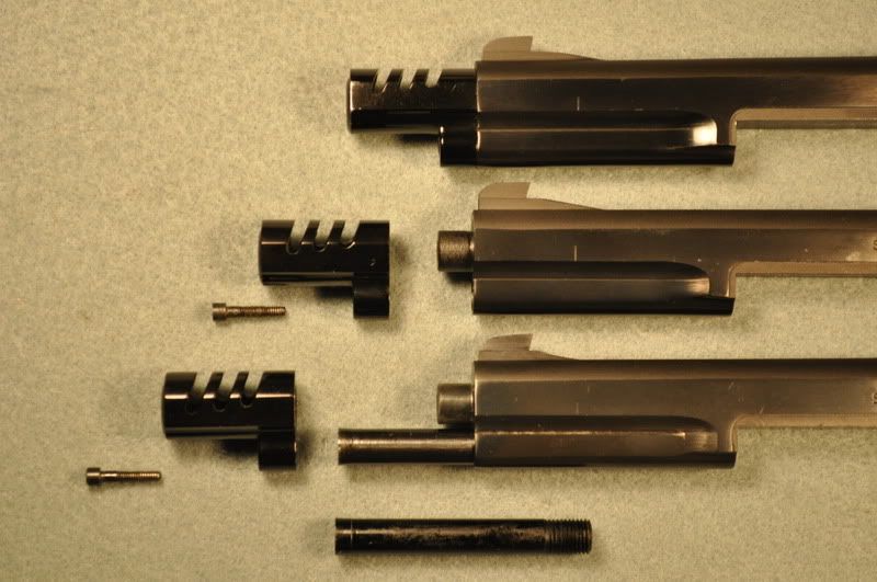

This shows how the muzzle brake and internal weight system works on the 7 3/8" barrel. Note the 3/8" barrel nub at the muzzle....this is what the muzzle brake fits over and is one of the differences between this barrel and the later 7" barrel.
External and internal weights for the 7 3/8" barrel. Both were available in steel or aluminum.
Here are some barrels....aftermarket Clark, two 7 3/8", 5.5" heavy and 5.5" EFS (extendable front sight)

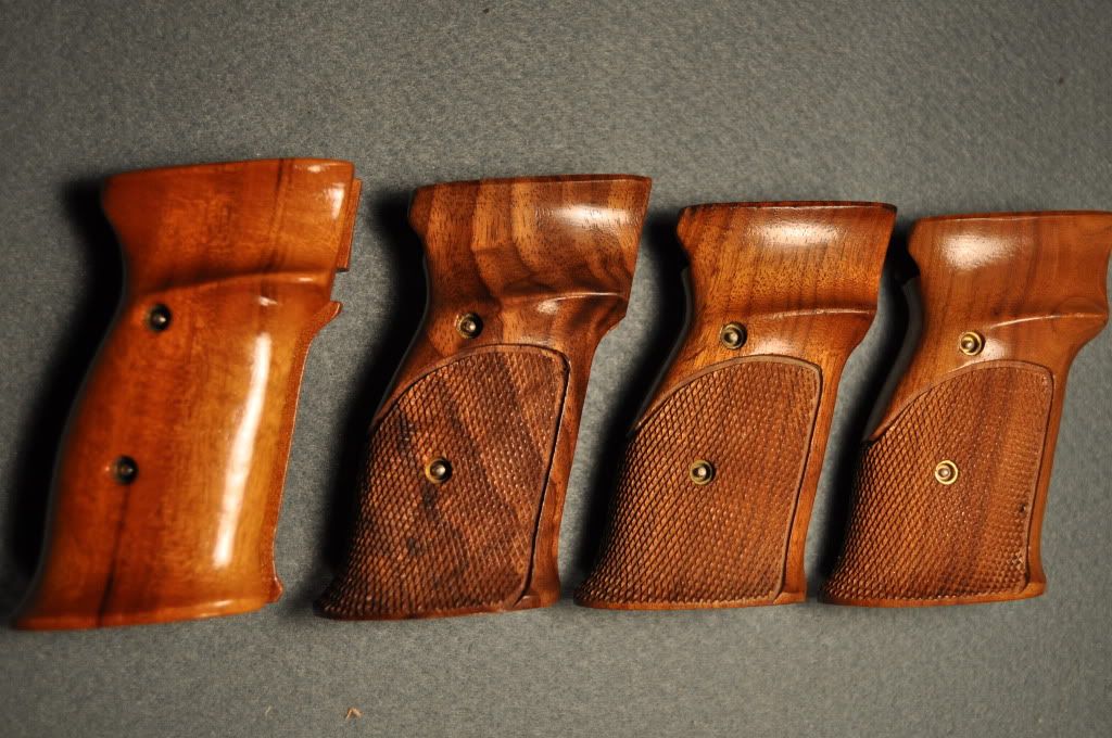

Factory smooth grips for the Model 41 do exist but I've never seen any Model 41 grips, smooth or checkered, in Rosewood. S&W did use Rosewood occasionally for revolver grips but they were never as common as Walnut or Goncalo Alves. These woods are sometimes mistaken for Rosewood so that may be what you are seeing. Rosewood has open pores and this is one way to distinguish them.
Smooth Goncalo Alves on the left and three Walnut sets:
