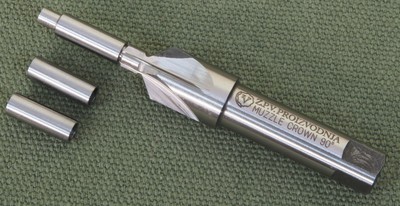

The tool doesn't cut 90° and 110° crowns, they are as I stated the angle between the cutting edges.
So in fact the 90° tool will cut a 45° crown and the 110° will cut a 35° crown.
The drawing I made may help those who don't see it... View attachment 377264

And here we have Brownells even mentioning the 45° crown angle - achieved using a 90° crown cutter. Not all crowns are 11° :) CZ factory crowns sure aren't.
Making sense yet? :p View attachment 377288

I've always used a 90° (as per Lewis's diagram).
This gives a 45° angle at the very lip of the bore.
Never used those wee cutters (but they do look like a neat idea).

I might have to get me some of those wee cutters.

But those wee cutters you show do look interesting. What/where/etc details please?
