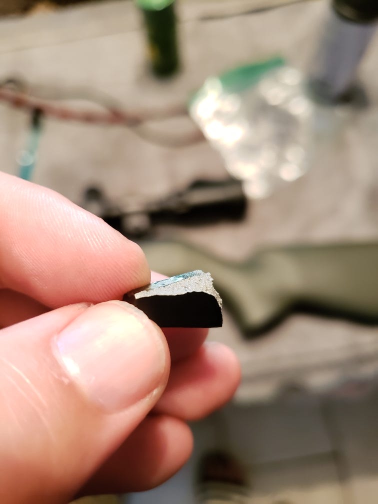

Well, took my 597 to the range today to make sure my scope was zeroed.. shot made a weird sound and I thought I started seeing like Gas/oil blowing out the top.
Groupings went from a dime to 1.5 inches.
I come home to give it a quick clean without disassembly and notice the oil I sprayed on the bore for the bore snake was leaking out around the outside of the barrel where the barrel/bore goes into the receiver.

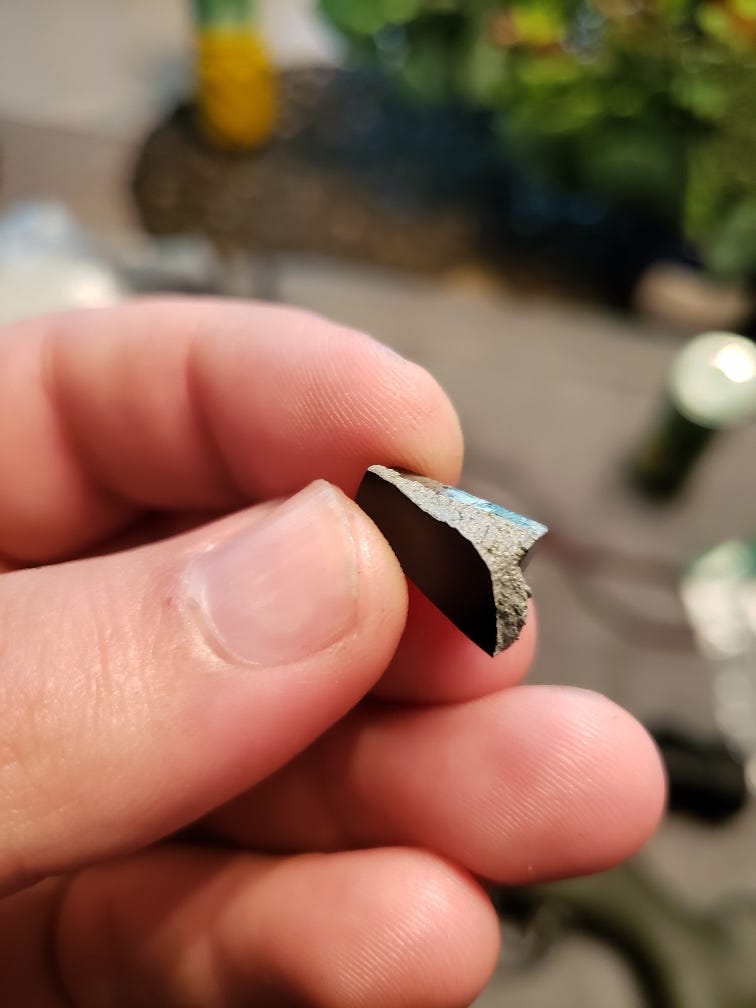

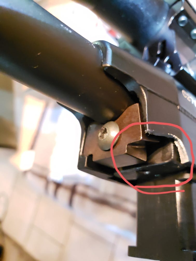

I took the action out of the stock and first thing I notice is the barrel is loose, I look and the **** receiver cracked off right where the barrel wedge holds into the diagonal cuts in the receiver... ***. It looks like pot metal. This has always been hand tight. I've never used a drill or even a T handle. Usually just a small Allen key.
With my first match tomorrow I dont really care why it happened at this point I just wanna know
1. if its safe to shoot (even tho groupings sucked since it happened) I locktighted the screw back in to hopefully hold it tight enough off the other side of the receiver that didn't crack.
2. Is this a known problem? Did I miss a recall or something because its a joke that that part of the receiver that holds the torque for the barrel looks like its made from cast aluminum or some mystery metal.
3. I already emailed Remington arms but won't hear back till at least Monday. Has anyone had the receiver replaced for this issue or fixed this problem? With the 597 being discontinued for so long is my only option to JB weld it?
If it is confirmed that remington no longer carries parts or support for the 597 than i will attempt to JB weld it overnight and use it at my match tomorrow.
Please help lol, I bought this as my first gun when I turned 18 in like 2012 and I'm PISSED.

Sorry to give you the bad news Mav but if you can fix it you may be the first. Our resident Mod Flysalot is the eggspurt of all the ways that don't work including tig welding if my memory serves. It is the Achilles' Heel of all the 597s.
I have a guy, he's an aerospace welder and he tried 3-4 times to fix mine with zero luck (n):cry::cry::cry::cry::cry:
I tried JB weld and no luck.
Safe to shoot? The stock will hold it, but I wouldn't.
I had one that was cracked and didn't know it for a while, no harm but it patterned. Sadly, that cover IS the receiver and as such it's a controlled part.
I wish I had better news. At one point I had 11-12 597's but I've sold them off for this and other reasons.

Just my experience. It will re-break. Been there done that. Pot metal just don’t work. I have thought about micro drilling a hole in both, then inserting some
micro rebar and then JB it. I think it would still require some additional on the outside face after some sort of roughing it up. Still it would be a MacGyver. I like fixing it myself also, but sometimes they just can’t be revived. Fix it and use it as a template to blueprint it. Someone could 3D scan it.

There is nothing wrong with the design of the 597 and no proof that Remington cut any corners. If you look at the wedge block screw in the Op's pictures you can plainly see it is buggered up. Someone along the line of ownership over torqued that screw and the Op has paid the price for it. Like most .22 rifles, the 597 was built to a price point that necessitated using an alloy receiver. Same as the most successful .22 in history, the Ruger 10/22.

I attempted to fix one with Epoxylite, didn’t hold. This stuff is commercial grade epoxy that they use to make repairs and machine it. 2nd try: drilled through bottom edge with #45 bit in two places. Used bit shanks for dowels. Re epoxied, didn’t work. I don’t know what that metal is but when drilling it had a slight stink. I think that means high content of Arsenic, which is usual hardening alloy in soft metals. I wonder if the problem with 597s is a quality control issue with their alloy, not design failure.

I am unfamiliar with these rifles, but judging by your picture that wedge clamps the barrel upward against the top of the receiver. If welding doesn't work, I don't see a way to repair the receiver given the high load that wedge applies to the thin cross section that broke. As an alternative, it looks like you may be able to emulate the required clamping action by wrapping something over the top of the receiver that pushes upward on the wedge. I'm thinking a U-bolt, or if you want to be really cheap and tacky, :giggle: maybe a hose clamp.
To be clear - I have no idea whether a U bolt would be a safe method of repairing this since I have never seen one of these rifles in person, but the pictures suggest that it could be - try at your own risk.
