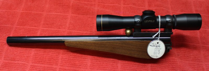

What are the pros & cons to both. Accuracy? I will use it for hunting. Thanks for replies.

I thought the same as well. Since I already owned a Contender carbine in .223 Remington (21" barrel), figured the Super 16 30-30 barrel made a lot of sense. The very common 30-30 Winchester was another factor in selecting that round and not one of the better but far less available custom 30's.
The 30 Herrett was designed around the 10-inch barrel length. Its purpose was to get as much as possible in 30 caliber (35 as well) from the shorter 10" length. This was because of all the noise and fireball generated by the 30-30 in a ten-inch tube. The short 10-inch barrel just wasn't long enough to use all the 30-30 has to offer. Sort of like how back in the early 1960's the 221 Fireball was used in the ten-inch XP-100 pistols instead of the 222 Remington. With the 14-inch barrel (or 15) things begin to change and the 30 Herrett and 30-30 are pretty much on par. But with less of a fireball from the 30-30, although it's still there. Among the various T/C Contender barrels I have a 14 inch 30-30 that gets 30 caliber 125 grain varmint bullets and is used for antelope. The lower velocity from the 30-30 Contender as opposed to say a 30-06 allows these bullets to act more like a regular hunting bullet than an explosive varmint bullet. The accuracy potential is basically a question of how well you can hold the pistol.
