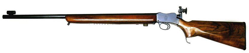

Another great option for prone and other position shooting with iron sights is Martini target rifles, especially the 12/15 or the Vickers Martini. I have owned one of each and sold them only because my disability does not allow me to shoot off hand.
Martini 12/15:
Vickers Martini:
By the way, the most accurate (non-BR 22 LR) rifle I have owned was the Vickers that I bought and later sold here through the RFC Trading post for the same $450 I paid for it. The $450 bought the rifle and target sights with a complete set of front sight inserts. You do not need to break the bank to get a great rifle but a lot of research is needed to be able to recognize a real bargain.
