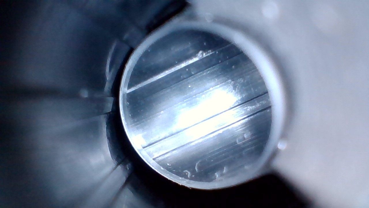

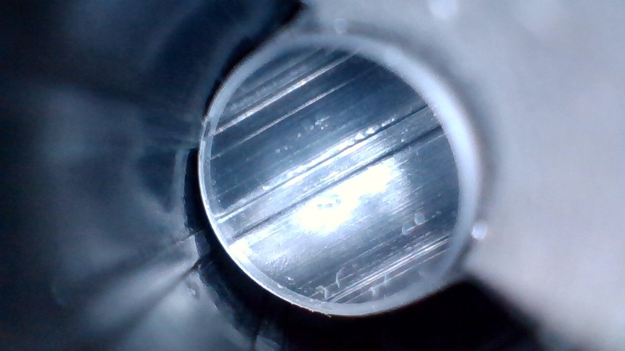

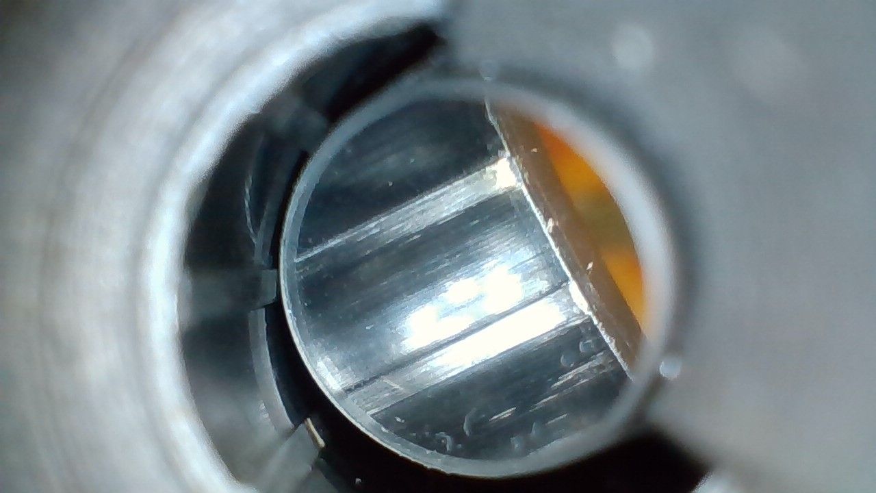

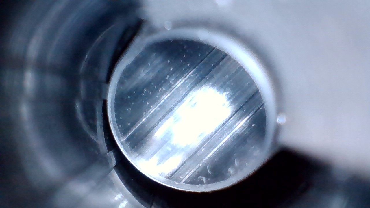

Now that I owned a borescope, I used the heck out of it to check the results of my cleaning. I was never finished cleaning until the last speck of the ring was gone!

Borescopes... If you care about ultimate accuracy, and you don't own a borescope, I highly recommend that you get one. If for no other reason, just to keep tabs on the effects of your cleaning regiment. They come in handy for inspecting crowns and all kinds of things not gun related as well.
I started off with a Lyman. It will allow you to see everything that you need to in a barrel. Ive since upgraded to a Hawkeye. DJ's hawkeye to be precise.. Thanks again Don! It really doesn't matter what scope you get, but I do recommend that it is capable of a 90° view so that you look straight down on your chamber or bore. I can't make things out as well if I'm looking straight down the pipe. YMMV
