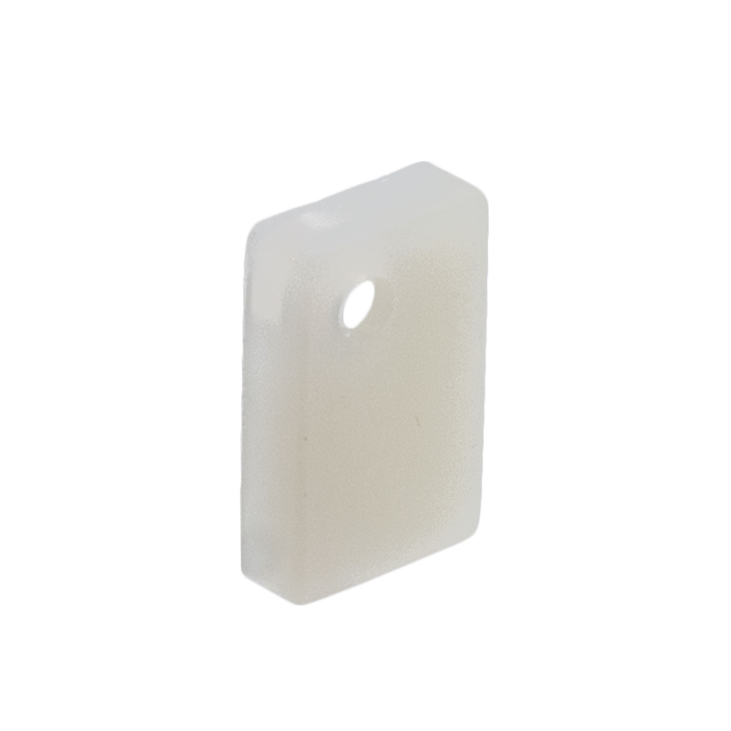

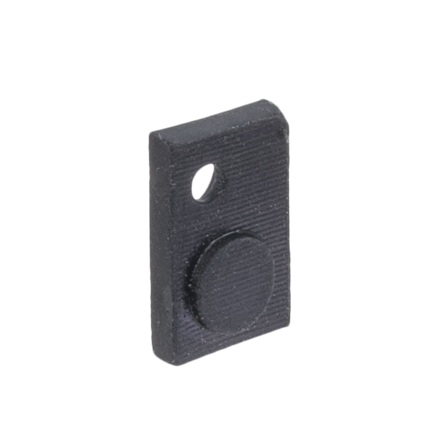

Part number 4. It's a little kind of plastic or polymer piece. Like $4 I think on numrich but there are two different kinds apparently.
Mine used the black one Type 1
I believe this is type 2. And it's for newer year models
Here is the part listed on Numrich
I am not sure if they are interchangeable. I would think so. But you never know.

My Buck Mark does this ,it was really bad until it was pointed out the buffer issue I was unaware of. Mine has factory polished feed ramp .
My thread below describes it, mine has very little round count 300-500 tops and was not dirty at all inside but the buffer had came apart .
After detail cleaning with CLP , new rubber buffer .The new ones are flexible. I ran 30 rounds ,fourth mag second round Jammed just like OP in this thread.
