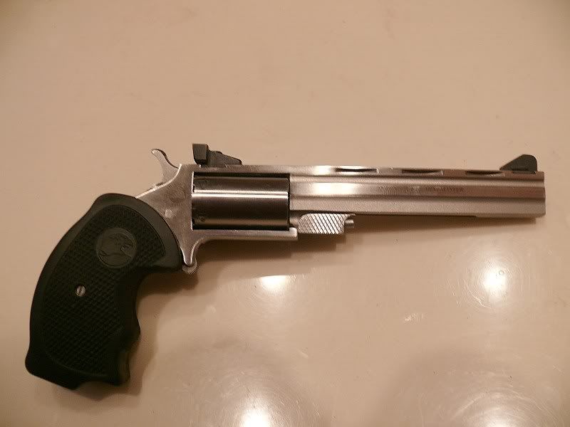

Mine is a Mini Master so the sight radius helps a lot but I can bust clays at 25 yards now where before it was a random event.

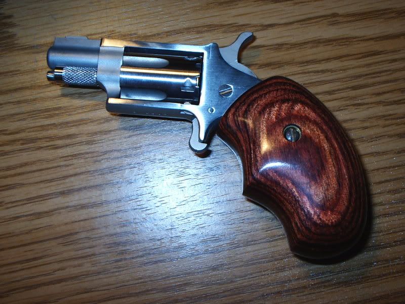

Don't forget, they fit sloppy and you'll need to bed them w/ some epoxy to get a decent fit to the frame. Don't forget the mold release! [Wax, Pam, whatevs... just something to keep the epoxy from sticking to the gun while it sets up & adheres to the grips...] And they're still not as good for accuracy as the Secret Service grip that NAA sells, but do remain more concealable like the original bird's head grips.
I tried the revisioncv grips and didn't like them that much. They are still to narrow to be comfortable. I did a little better with the boot grips from North American Arms. But for my hands, the Mini-Master grips are the best feeling:
https://northamericanarms.com/shop/accessories/gmm-m/
They do increase the overall size of the NAA reducing one of the revolvers bests features; it's size. But if you want some nice looking, real wood, "potato" grips, check out:
http://thingmeister.yolasite.com/
