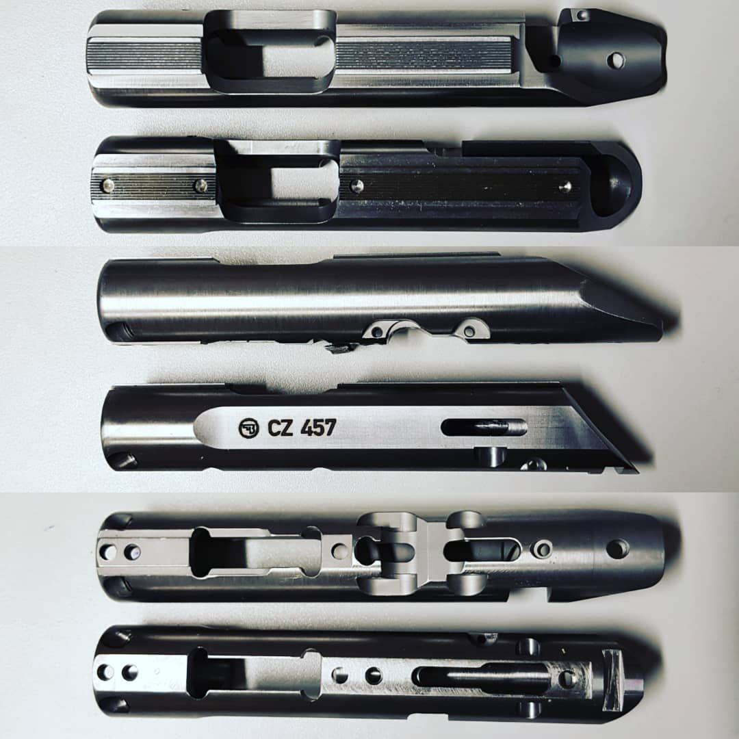

And as also noted above the receivers are different and so stocks are not interchangeable between 455 and 457 models. The picture below shows the differences, key among them the location of the action screws.
I can also confirm that the barrels are definitely interchangeable. The stocks, however are an entirely different story. As stated in earlier replies, the receiver is quite different as well as the trigger/trigger guard assembly. I currently have a 20" 455 22LR barrel on my 457. Not relevant, but this particular barrel thinks Federal Auto Match actually is match ammo. I'm not going to tell it any different :D
