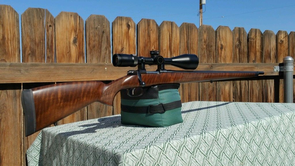

Hey guys I need some advice on the 22 Hornet...I already have a CZ 527 in 222 that I just got...I took the rifle out started to sight it in and that's is as far as I have gotten so far....I have the hots for another 527 in 22 Hornet. I have everything but time to reload the 222. The 22 Hornet looks so nice and is a smaller quieter round...the factory 222 is too much like shooting a 223 being loud and proud right for the moment. The 22 Hornet looks like a 22 mag on steroids. :D
I am having second thoughts on the Hornet because I have not done any reduced loads on my 222 yet. I was going to order the 22 Hornet this morning...and no I am not interested in the 17 hornet. I already got the OK from the Boss Lady (wife) to get it.
So what would you advise I do ??
