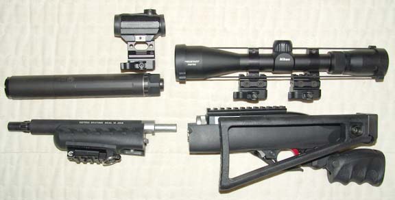

I have a Charger that I SBRed. It started life braced but I wanted to use it for steel challenge and in that form couldn't be used. But as a SBR became legal. It wears the Ruger furniture so no weight cut there. I did move to a TacSol 8' barrel and saved some weight there and made it far more accurate. A BX trigger completed it. Later I did add a KIDD DLC bolt just because I run it silenced and that makes it easier to clean.
Weight? 4#. But if I move to a light weight chassis that can be reduced. It's light enough IMO. Small for transport? Yup. Breaking it down no part is longer than 10.5 inches and that was the scope that never goes on it anymore.

I wanted to make a tool roll for it but as of now I haven't. The red dot uses lever type mounts and it returns to zero (so did the scope).
