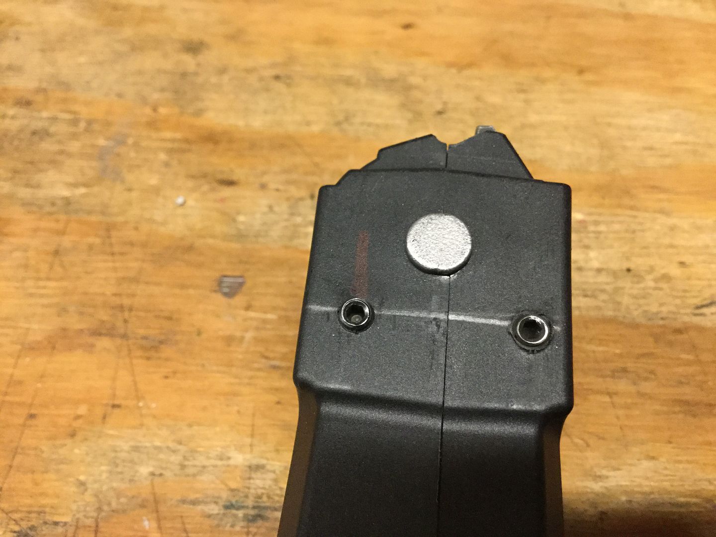

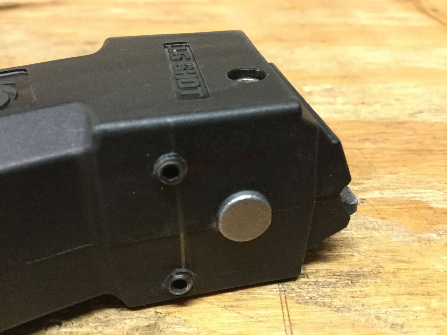

I drill and tap two holes in the front of the mag housing and put two set screws to eliminate any movement of the magazine in the magwell. Takes a little bit of adjusting to get it right, but my results have been very positive.

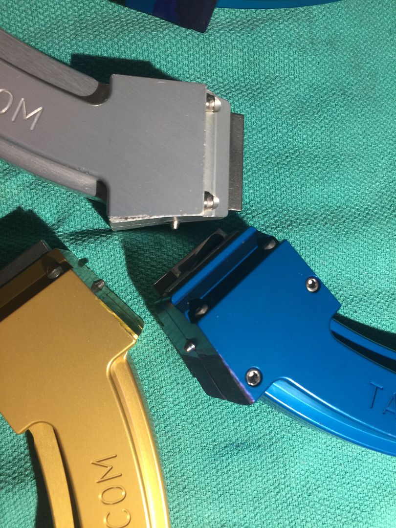

A sloppy BX10 is a far different animal than a BX25. Different feed mechanism, different spring design- rotary vs straight feed with coiled retraction spring on the 25... a BX10 can be TUNED for different spring tension- not so easy to do with a 25.
Then most important is the weight difference and it's distribution... a BX25 will sag more on a loose connection. I have about a dozen BX25s and 6 of The Tactical Innovations Billet mags, which have 4 set screw on the top which allow you to set the depth and angle that the mag sits in the well with a high degree of precision.
I know you don't want to hear this part- I rarely use my BX25s because the TI mags are far superior. The problem is that they cost A LOT.

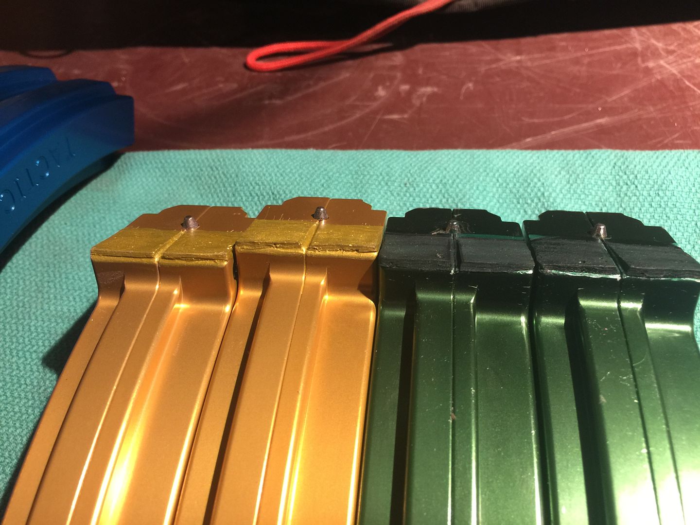

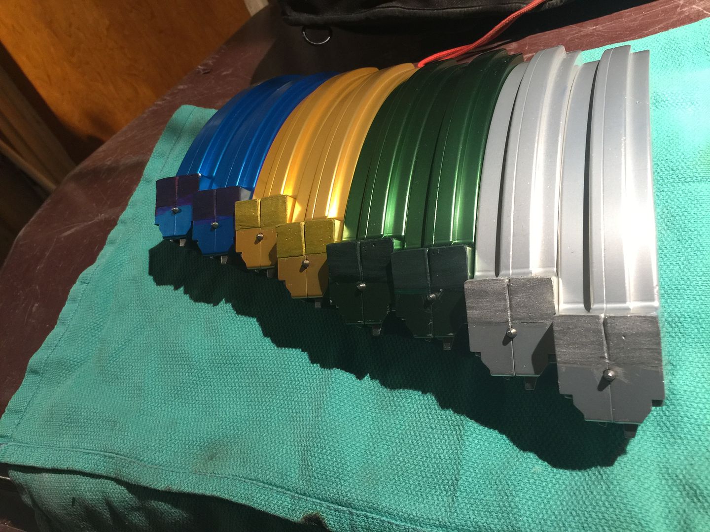

I used to apply layers of clear tape on the bottom/rear of my BX25 and TI 25 Mags to counter the mag sag that came from the slop inherent in the Mags design. I thought about bedding them with Devcon years ago, and finally got around to doing so...
It worked great!!!
I'll post a thread in the 10-22 Action forum. Eventually I'll get around to applying the same treatment to my BX 25s, and when I do I'll take pics and make a How-To thread on the topic.
