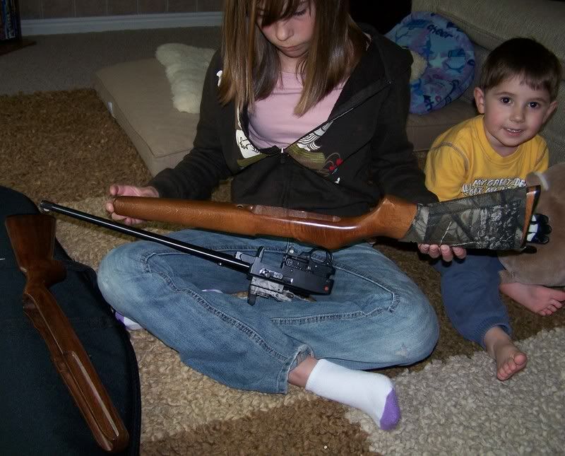

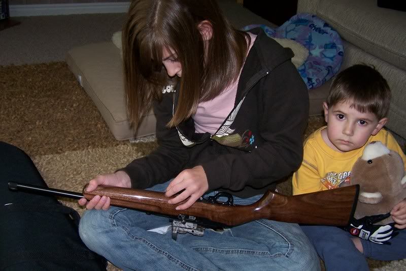

This was my daughters 10/22. Started out life as a regular carbine. Bought a used stock and cut it down and bought a youth barrel for it. She is now grown up and we have returned the rifle to it's original stock and barrel which she uses at Appleseed.
