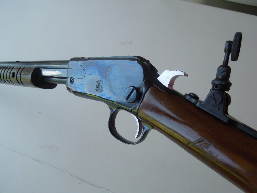

I have this tang sight on my Rossi 62SA and it works great. Also have it on my Rossi M92 (357) and again it works fine-- as it does on two different Henry lever guns.
Sorry that I can't help much besides post a pic of my setup. I did some (very) preliminary shooting and the correct elevation is well within the adjustment range of the tang sight. Good luck. :confused:

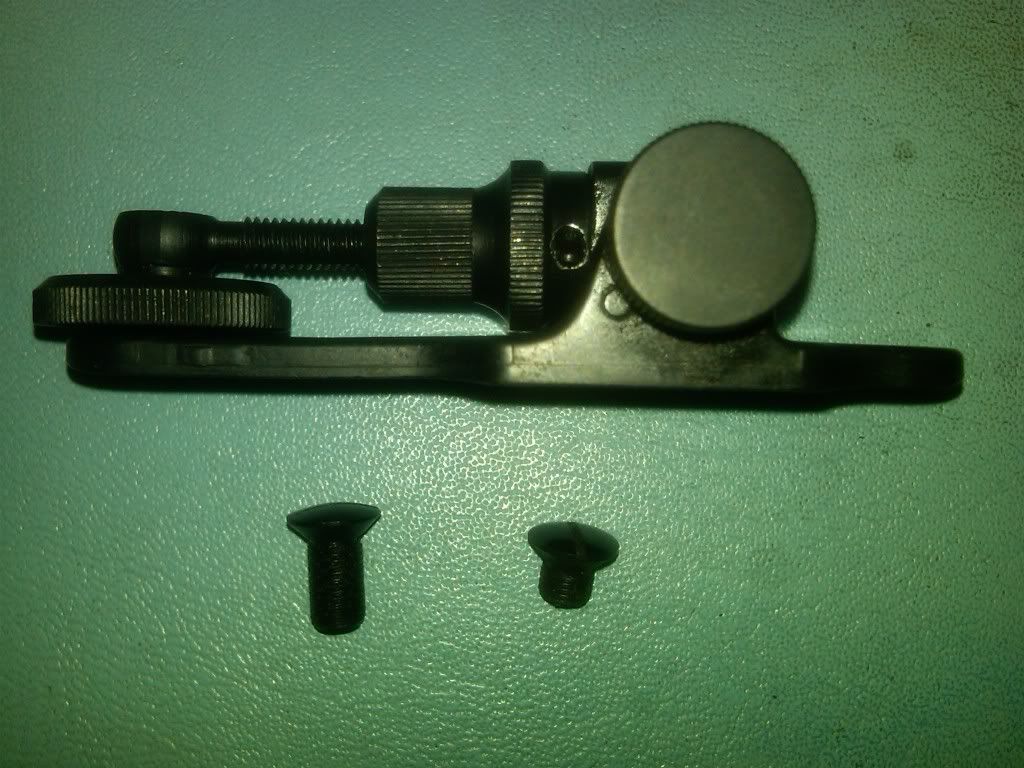

My front sight is stock and I have adjusted the tang sight to the max height and its still not tall enough to shoot 100yards. I have also taken the sight apart and inspected it and there is no problems in height adjustment, there is just not enough of it or it was not intended to shoot that far with this sight.
This sight did come with two short screws so it is definitly not for the model 62, the model 63 pictures I seen looks like the stock has less of a drop than the Model 62. My 62 has a bolt that pushes back and sets the hammer so the tang sight has to sit back and lower on the stock to use the mounting screw.

Two short screws, that does sound a bit odd. My LGS ended up using a different screw in one of the mounting holes for mine but I can't recall which exactly. :confused: I know that the longer of the two tang screws I have is pretty darn near too short for sufficient thread engagement on the bottom tang.
What is the length of each of the screws? I can take a closer look at mine tomorrow afternoon and give you a better idea of my configuration.
Here is a pic of the Taurus Tang sight fully extended and the screws that came with it as well as the rifle I am trying to put it on. I usually always shoot my 22lr rifles at 100yds and my 22lr pistols at 50yds I recently got a 22magnum and started shooting 200yds with it. I was planning on leaving the stock iron sight on the gun and sighting it in for 50yds and then putting the tang sight on and sighting it for 100yds. That way with the tang sight down I can shoot as regular iron sights and with the tang sight up I can shoot distance out to 100yds looking over the Iron sights since you have to sight higher for distance. I just cannot get sighted in for 100yds with the Taurus Tang sight

Quick and Dirty pic of Taurus Sight on Rossi
Here is a quick pic of Taurus sight on Rossi. I do not believe that the gunsmith drilled two holes, only one. Note that the lower screw of the sight is at the rear of the tang. When I shoot the rifle with the tang raised, I do not recall any discomfort.

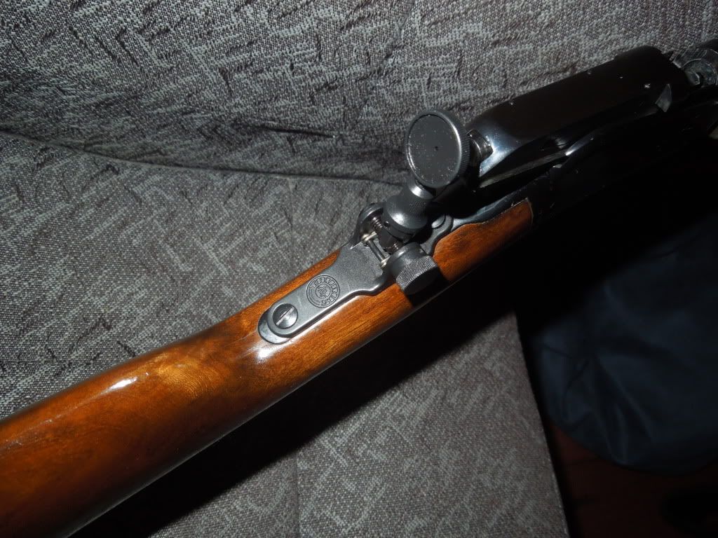

Some more pics Taurus tang on Rossi 62
Trying to improve my Photobucket skills! This is my Rossi 62 with Taurus tang sight. To get a clear rear to front sight view, I drifted out the rear open sight. Does anyone know what size blank I can drift into the empty slot left by removing the rear sight.
Now that I see close up pictures of your sight, I can see there is a difference in them. My pictures of the Taurus Tang sight is fully extended and if you look at the threads, the last 1/4 inch is not threaded but on yours the last 1/2 is not threaded, this makes me beleive you have at least 1/4 inch more height than I do.
