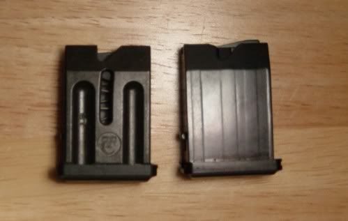

ttshooter is one of our sponsers here at RFC and he does excellt trigger jobs on Classics. My other question is do you have the new style magazines? T/C was replacing the old ones for free. I think they still are. Most of the feeding problems people have had with T?C's is either a dirty gun or old style mags. I find if I clean the action out with Gun Scrubber every 400 rounds or so mine is dead reliable. Yeaster I had one stove pipe jam....the first in a long time but the rifle has about 350 sice cleaning and all 5 of my mags are old style.

There was some pictures posted that show the difference and you may be able to run a search on the T/C forum and find it. Since I have only old ones (mine work so well I haven't bother T/C for replacements) I'll have to go by memories and you know how dependable that can be! The old one are solid on the sides and almost smooth with just some very slight raised or lowered areas. T he new ones have very marked depressions on the sides, The side of the mag has two very deep hollows.
If any of you guys could post a picture of the new mags would you please do it? Thanks so much in advance.

Like Vincent said, the old style magazines have smooth sides, while the new mags have 2 sculpted cuts (flutes?) running the length of the magazine, from top to bottom on each side. They are probabley about 1/8 inch deep. I have tried both, and they seemed to work fine for me.

Thanks Vincent, Chunckchucker and Mr GAP for the info, looks like I have the new mags with the grooves down the sides. I have a 5 and a 10 shot mag which I took apart and thoroughly cleaned them this should help with feeding.

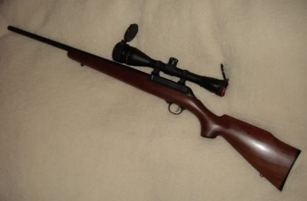

At present the scope is a Nikko Sterling 3X9X40 set on 7, I plan to replace the Nikko with either a Bushnell 3200 or a Weaver designed for 22's this should help as I have allways held the Nikko in question. Any suggestions on other scopes?
In general I really enjoy shooting the Classic the fit/finish and good looks of the walnut stock is superior to all the other 22's in the price range including the bolt actions. Its just a matter of fine tuning the trigger and finding the right ammo, I will be downright thrilled if I achieve 5 shot accuracy of 1/2" @ 50 yds.

I have the Weaver RV7 2.5X - 7X 28mm scope in Talley mounts on mine. It is such a pretty little rifle I just could not bring myself to putting some huge, klugy 36X scope on it. I'm very happy with this combination. :t :t
