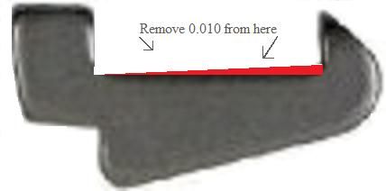

extractor fitting
Keep hearing about fitting the extractor would love to see some pics and or drawings of what material needs to be removed where
thanks
Fitting the extractor to the bolt is easy. The extractor hook has to have enough pre-load on it to hold the cartridge case tight to the face of the bolt as it recoils until the base of the case hits the ejector and gets kicked out of the action. The case rim should push the extractor out of the way by 0.015" as it is slid up under the extractor. This gives the pre-load needed.
To get more pre-load you have to make the hook longer. The extractor is stopped in it's travel towards the cartridge case by it's machined slot in the bolt. To make the slot deeper would make the hook effectively longer, but man what a PITA. It's easier to modify the extractor.
If you look at the extractor you will note the hook at one end and the square lug at the other. Where you need to remove material from is the flat that is between the hook and lug. With the hook and lug facing up, I clamp the extractor in a small vise. I keep the area flat, but remove more material from the hook end. Take about 0.010" off and check the fit.
When you get the 0.015" cam out, break all corners to remove burrs or sharp edges and you're done.

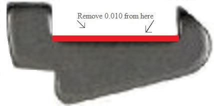

I make it tapered, taking little off of the left end. What you show is the correct area.
Yes, that is how you remove the material. Not to get picky, but the red line should be below the original line of the extractor, but you have the idea down pat. In effect this makes the hook of the extractor longer. This in turn will make the extractor hold the spent case on the bolt face tighter. The width of the extractor is not critical.

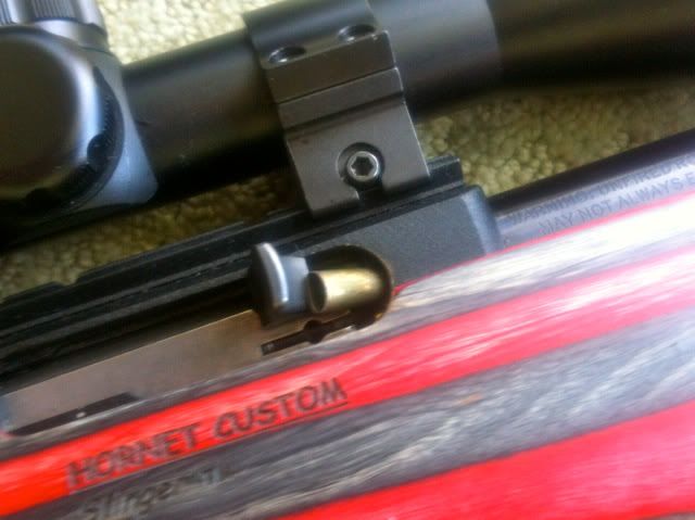

Opps I think I have the wrong definition of a stovepipe. The problem I'm having is live rounds getting caught going into the chamber. When you pull the bolt back and shake the gun ejector port pointed down the round will fall out (sometimes with the help of a finger) and the bullet will be bent. Again using stock mags.
In this case I would definitely try different ammo. Some guns just don't like the Win 333's. Break it in with some lead round nose ammo (Fed Automatch or CCI-SV) and then go back to the cheaper bulk stuff. Might need to clean the mags because the Thunderbolts you originally used is definitely dirtier than most. I have had similar problems when the crud builds up in the mag and doesn't allow the bullet to be pushed up high enough for the bolt to strip it.
When it jambs where is the bolt? Is it behind the cartridge case trying to push the round into the chamber, or is the bolt hitting the case in the mid-point, setting on top of the round?
The round is almost out of the clip at about a 50 deg angle with half the bullet in the chamber bent, the bolt is behind the round. I added one of those blocks that lock three mags together. They are new stock Ruger mags but I wonder if they are not seating completely due to a block/stock clearance issue. I had two guns to sight in Saturday so I did not pay too much attention to it. My dad was watching my daughter making sure she was safe, I just know I had to clear the action quite a bit. I figured I'd take it apart later. On it's first range trip it was flawless but I did not have the clip block either. I'll look at it closer tonight.
