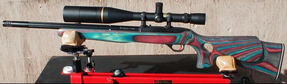

Here's an example of just one of those I've built.
Ted
Nice lookin gun Ted!!....I'd be a little nervous to take it in the bush though.....Wouldnt want to scratch it up or have my hunting partner looking at it with with a watering mouth.......He commented that it looked good enough to lick like a lollipop!!!!....What do you use it for?...Does it ever come off the bench?
Off the bench
Constantly out shooting with it. When not on the rifle rest shown it sets on a Buddy bag. I do use this rifle a lot for PD's and Gophers. Here's another one to look at.
