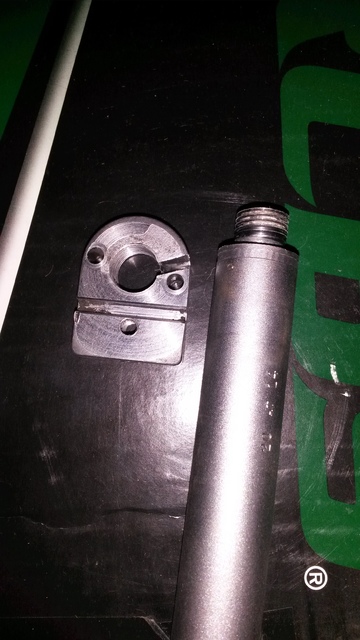

I cannot tell you exactly what year it started but I think around 2006, but Remington started to use 5R rifling in the 597.
So, your options on drop-in barrels are limited. However, notice that the barrel threads into the "tombstone" which is then clamped to the receiver. You can purchase a blank barrel from your preferred custom barrel shop and have a gunsmith fit it to the rifle. I had a Lilja fit to mine with very good results, you can find a target here in the 1/2" challenge thread shot with it.
