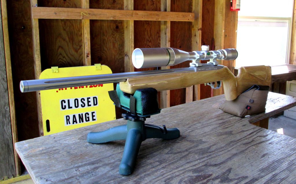

I finally had to try a Kidd barrel and trigger kit :rolleyes: Hate to admit it, but they rock! I had originally set this action into a Raptor stock, thinking I would call the build "Me2" because it was pretty typical and represented my final capitulation to the Kidd crowd, but then a great deal appeared in the TPC on a custom Maple stock with varmint characteristics. I devised a plan to make the gun a SuperSport Heavy instead of an Ultimate, though it may push the envelope a little :eek:

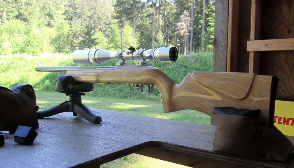

Anyway, as you can see, the stock rides the bags pretty well, though I need to make a flat pad for the front rest instead of the U-shaped bag it came with, as the forend has a flat bottom. The butt area is really thoughtfully shaped, with a nice curve to adjust the point of aim with a little sliding on the rear bag while still maintaining stability. Great design! Props to Mkling :bthumb: I love the flutes in the forend, though I hesitate to call them "fingergrooves" because of the overall width making an encircling grip unrealistic. They are great for a front thumb hold against the rest, though, and really break up what could have been a blocky area! The stock has an aluminum pillar, BTW, and the action centered nicely with no adjustment by shimming.
The grip area feels great, but finger placement on the straight trigger could be better. I think a curved trigger might feel nicer; future change perhaps.
Action:
Ruger OEM Silver receiver and TG
JWH bolt and handle
Kidd 20" fluted stainless barrel
Kidd trigger kit
Mueller APV scope
Leupold rings
