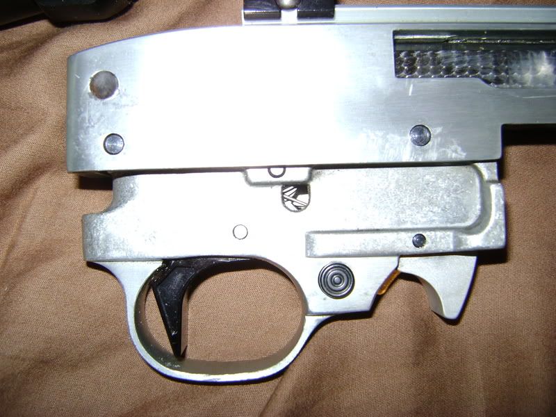

You can see inside the trigger group window, the bobby pin. It works excellent.
Next is the hole that Skeeter puts in his triggers. Very useful for adjusting his sear that he sells.
