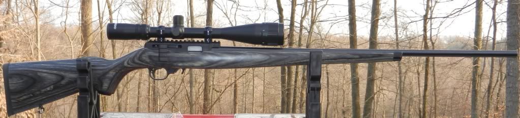

And Buckweet here is the stock wearing a PWS T3 toggle action and a 28" GM tapered barrel.

Plinker... and here, i have this 28" GM barrel....
You have posted a rifle that i thought?
Was only in my dreams. :)
Only difference is. My dream rifle had a Weatherby Mannlicher stock...
But yours is sooooooo close !!!
Bloody good looking rifle! !!!

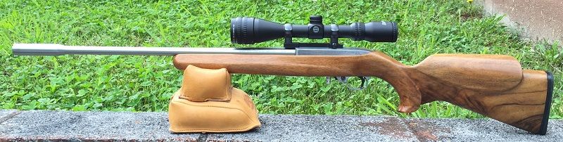

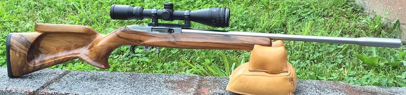

Swapped manlicher stock with this English walnut.... Has a nice balance.
Very Nice! Very pretty! :D:bthumb:
To be very honest I like this much better than the Mannlicher style stock. Was a nice rifle before but this stock takes it to a whole other level!
Anyone would be proud to own this rifle
Eye candy Plinker. :bthumb:
