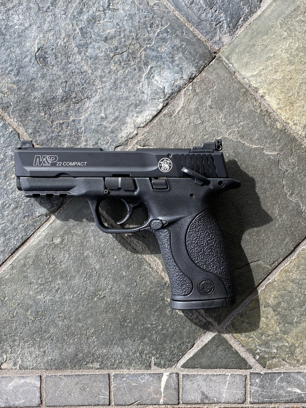

Made up a holster for my M&P 22 Compact...OWB, rides high at my customary 4:00 position. Regards, Rod
