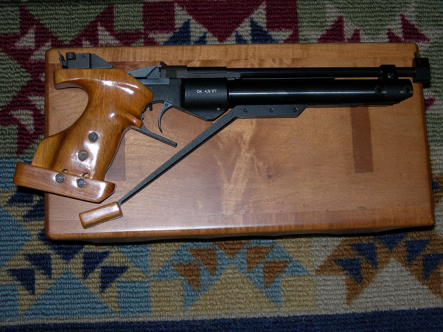

This was the second that I have owned.
Good little gun, but sometimes I shoot a hundred of so shots in a session.
My arm gets tired from the weight of the gun (nose heavy) and from the cocking effort.
I was right in selling the first one and wrong is buying a second one.
Build quality is excellent.
There are a lot of moving parts - some under a lot of strain when cocking.
The trigger is excellent.
It is very accurate.
I modified the grips using a Dermal Tool and refinished them with Tru-Oil.
