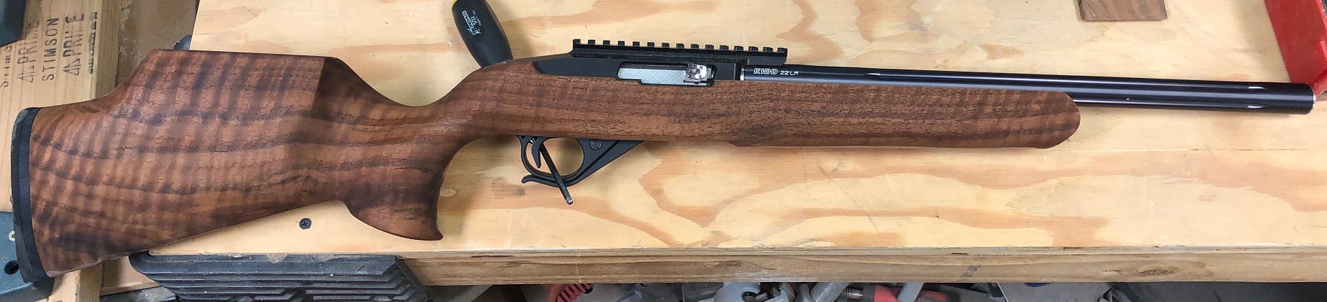

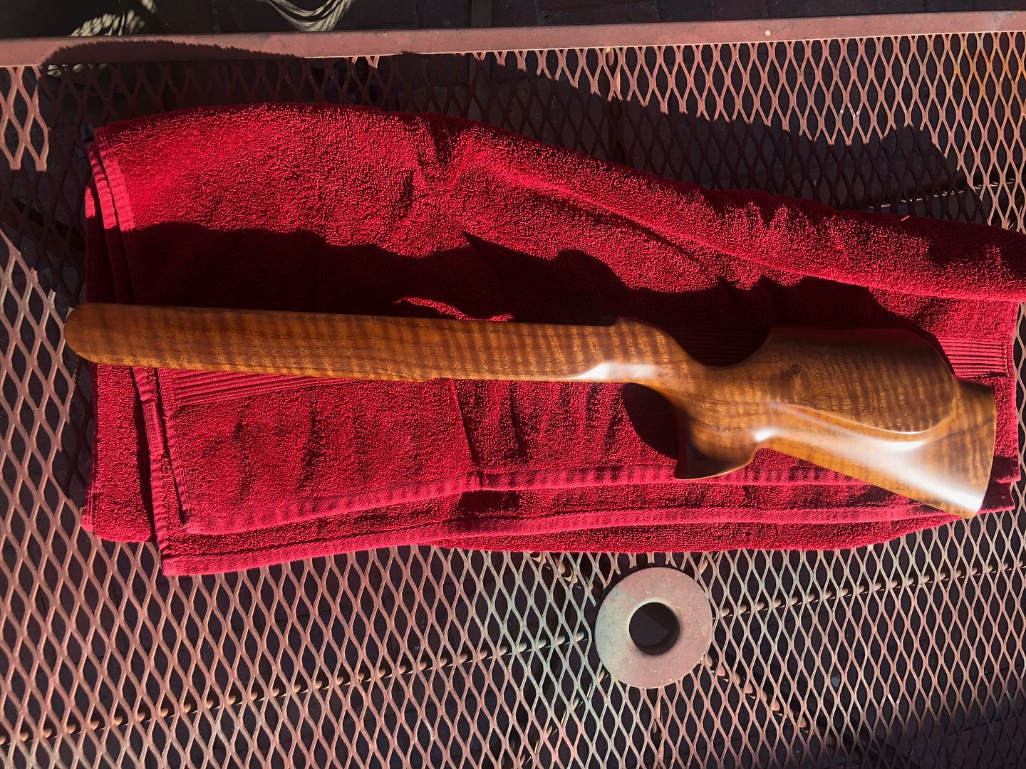

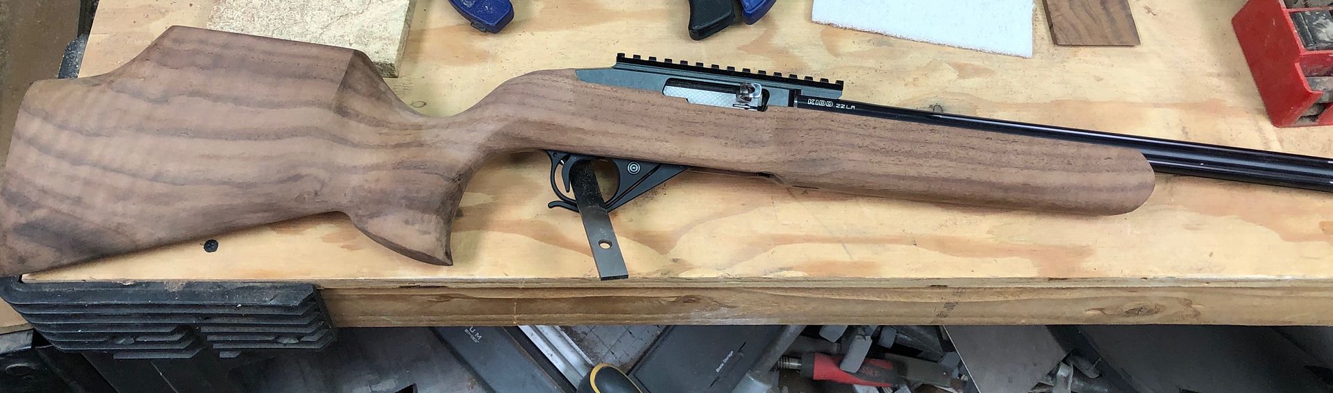

8.) Walnut Pharr Clone/Kidd Classic 16.5ULW
Walnut Pharr clone custom stock carved, finished, and pillar/rear tang bedded by azguy
Kidd Classic Receiver
Kidd 16.5” ULW Barrel
Kidd Scalloped Bolt
Kidd Charging Assembly
Kidd Single Stage TG
Bushnell Engage 4-12X SF scope
Leupold QRW Rings

imho, the issue with a 1022, and all guns, is action movement. The 1022 has one action screw, and that can act as a teeter totter and or a lazy susan.( rotation/ pivot ) . Docs method will make those non issues.
But , if youre not ocd, and a master craftsman, in other words , a lazy bum, like me ,a shorter screw, VQ comes to mind, and or a pressure pad under the barrel rocks the action back into the stock , so no teeter totter, and some harmonics tuning, and aluminum tape on the sides of the receiver,so it cant pivot, and your3 99% there for about 1% of the effort. Or if you just want to pay for it, then the Victor Titan Stock and the rear tang imho works darn good too.
The red white & blue Kidd rifle is probably the best one hands down!
It's certainly HIS favorite- overshadowing the full on custom Raptor that his Dad built. Hard to compete with one built and custom bedded by Tony Kidd.
You made him very happy, which is what matters!
