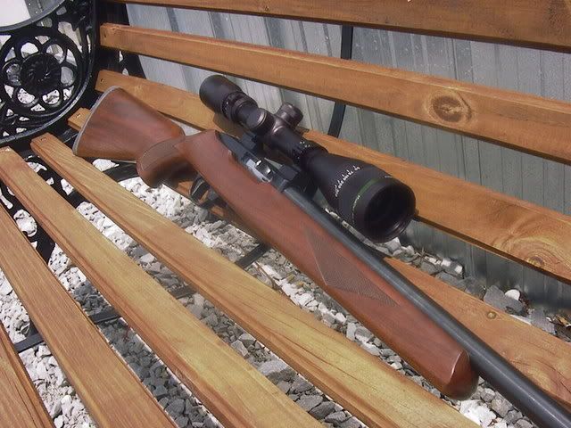

When I got it it had some small "issues" that needed to be addressed (still needs bedding changed) but it had about 3-5 (I do not remember for sure) coats of Arrow Wood oil (basically a 98% tung oil with a few additives) and in these pictures it has about 15 coats. It needs a couple more.

It is not what I would have chosen for a finish if I got the stock naked but I was afraid to change horses in midstream. After contacting "noremf" he said it would be a lot of work to change to something else and a possibility I would end up screwing up a very nice piece of wood!!:eek::(:(
