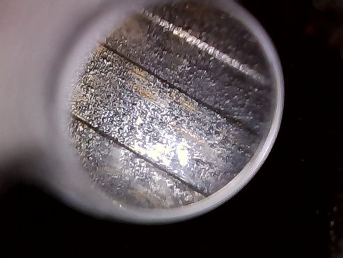

I decided to get one of these to see what’s going on inside the barrels. What surprised me was all the scratches on the lands of my cz 457 barrels. These look to be from the factory because they are perpendicular to the rifling. I use a Bore tech bore guide and .20 Bore tech rod.
I also have a Lilja custom barrel and that barrel is perfect except for the carbon ring in the chamber. I got that all cleaned up so I guess the scope is a useful tool.

This is what the bore in my 1926 Model 94 26” rifle looks like. Corrosive primed ammo and less than diligent cleaning took its toll. Yet it still shoots 2 MOA five shots groups at 100 yards with its Lyman 1A tang sight.
IMHO people get way too worked up about a minor nick or tool mark in a barrel. The last half inch of the barrel and in particular the barrel crown have the most significant effect on accuracy. If the crown isn’t damaged, I don’t get to worked up about what the rest of the bore looks like.
