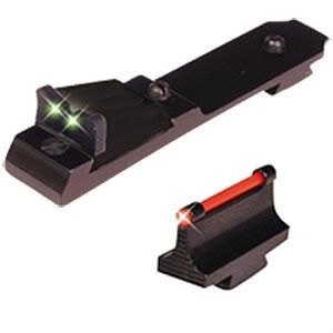

After the factory sights on my Frontier, it wore rear and front fiber optic sight. Very visible-- but did not improve my shooting or vision.
I then went to a receiver mounted aperture sight and a Lyman globe up front. This helped a lot; the apeature helped with my depth of field and focus-- but I did not like how it looked on the lever gun-- but it was an accurate combo.
After I tried a tang sight, I was hooked. Now every lever gun (even the center fire Puma) and rimfire pump I own sports a tang sight. With my tired old eyes I can actually see the front sight and my target at the same time- clearly! I find the tang sight to just as accurate as a scope out to maybe 50 yards.
For a front sight I use the red fiber and the Lyman globe with Lee Shaver inserts. I change 'em out every so often. I can decide which I like best. For killing cans, the red fiber optic is very good; but the light pipe is .060 dia. and at longer range, it covers the target. The fine shaver inserts in the Lyman globe are great for longer range target shooting.
