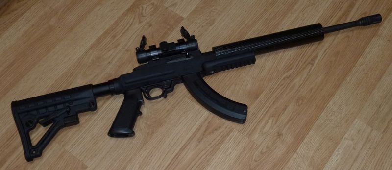

I'm going with an ARF collapsible stock and buffer tube and an ARF A2 pistol grip. I'll post pics when it's done.

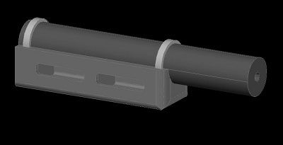

Hey everyone. I've been tossing around the idea of building a SBR off of a 10/22. My plan is to use the AGP folding stock, but I'm a little turned off by the lack of forend for standard barrels, particularly bull barrels.
I was tossing things around in my head, trying to figure out how to easily attach a forend without modifying the stock, and the design of the Magpul V-block light mount inspired me. I decided to model it and have it 3D printed.
It would have a ring of some sort to slip over the barrel and a forend that screws into that. Here's my design so far.
The first has a top handguard, similar to that of an M1 Carbine. I've included MLok slots at the 3, 6, 9, 10, and 2 positions for mounting accessories. The design could be lengthened or shortened, depending on the users preference. I also have a Keymod design.
The second would be a less expensive option that just uses 2 bands for the attachment.
My question is: How much would you be willing to pay for something like this? I've seen a lot of people want a forend for it, and I would want it as well.
Also, what other options would you like to see? Keep in mind, being 3d printed, the less material, the cheaper it'll be.
I do not currently have a AGP stock, but I plan on buying one soon. The biggest obstacle would be the barrel. I'm limited in my funds right now, so I can't buy one to prototype from, but if someone would be willing to send me a spare bull barrel, I would be happy to offer you a forend in the design of your choice, once I've completed the forend.

I finally got all of my parts and put my AGP Takedown 10/22 into my PMACA Chassis.
I am really impressed with the PMACA Chassis. I also own a Rhineland Arms aluminum Rail stock, and I much prefer the PMACA Chassis. I would describe the PMACA as sculpted as opposed to a block of aluminum for the Rhineland Arms.
And I have been really happy with the communications and assistance from PMACA. Excellent customer service.
I have also mounted my Charger, which is also based on the AGP Takedown with their 7.25" barrel and Micro CF Hand Guard, into the PMACA Chassis, and am very happy with that set-up, too. I see another PMACA in my future...
