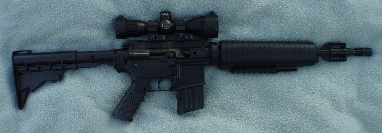

My Crosman M4-177 ... Corrections Officer M16/AR15 Designated Marksman Training Rifle
M4-177 with UTG 6X32 Compact CQB Bug Buster
For the longest time, I've been longing for a multi-stroke pneumatic air rifle that mimicked the look
and feel of the M16/AR15 system.
I'm retired from military service and am currently performing Correctional Officer duties
with the Texas Department of Criminal Justice.
As part of my periodic training, I must qualify with the AR15 at least on an annual basis - sometimes, more often.
If ever, the Texas Department of Criminal Justice were
to consider initiating a Designated Marksman Program
I hope I might be a contender.
Well fellas ... I went and did it ... Got an M4-177 with a 6X32 Bug Buster scope.
I've been wanting a scoped M4-177 for a long time ... now I have one.
I haven't had much of a chance to shoot my M4-177 after I mounted the scope.
As, I had a difficult time getting the rifle to put pellets on paper.
The scope required so many clicks to adjust ... I was a little thrown-off by the process.
After a few clips, I pondered the matter and turned to my privacy fence.
And, targeted a knot in one slate.
A few pellets with 3-strokes of compression hitting the fence ... I began to make quick progress.
Three full-clips later, I was on paper at five yards.
.................................................. ............................... Yep, an M4-177 .................................................. ........................................
The addition of the Leaper's UTG 6X32 CQB Bug Buster has added some needed heft to the M4-177.
My unscoped M417 is very light ... too light I think - I wished my carbine had more metal incorporated into the design for the sake of more weight.
By the way, the compact 6X32 Bug Buster really looks right on the M4-177.
I'm really impressed by this.
However, there is a small gnat in the ointment, the medium rings position the scope well on the receiver.
But, by design the AR15/M16 places the shooter head in an upright position.
As such, the medium rings are a bit too low to keep my head fully upright.
In the near future, I'll be swapping-out the rings with a set of high rings.
As I had expected, the addition of an optical sight sight to the M4-177 platform is a significant enhancement over the factory peep sights.
Nothing wrong with peep sights ... but, they are not the best choice when it comes to wringing-out more accuracy from a rifle.
The multi-stroke pneumatic Crosman M4-177 is no an exception - either.

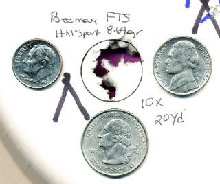

In-order to establish a good ZERO, I decided to simulate a typical shooting scenario I will encounter.
As such, I fired the M4-177 off-hand from a standing position with the hand supporting the forearm of the rifle
braced against an improvised shooting stand - very realistic.
Simulated Field Shot
Standing Position
Forearm Supported by Hand
Hand Braced Against Solid Object
Full Cheek Contact with Comb
Conventional AR-16/M16 Rifle Hold
Beeman (H&N Sport) FTS 8.64g
5-Shot String, 6-Strokes Compression
Not More than 10-Seconds per Shot at 20 Yards
Prediction based on information gleamed from
Plinker's Dream: Crosman M4-177 (Chrony, Accuracy, Photos)
NOTE: Kill Zone: .250
PBR: 12.8 to 21.8 Yards
Because of the methodology I employed in ZEROing the M4-177, the group was not to going be a single big hole.
As such, the spread was pushing beyond the bounds of a dime - if ever so slightly.
But certainly, well under a nickel.
All considered, still a good showing for a less than one hundred dollar air rifle at 20 yards.

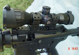

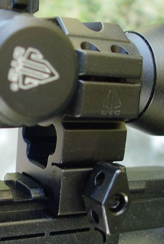

On an accelerated basis, I changed-out the quick detach medium-rings with a set of detachable high-rings as I had intended to.
Why? A couple of days after, I installed a Leaper's UTG 4X32 CQB Bug Buster on my Daisy 880.
While I was ZEROing the 880, I noticed that any head movement caused a noticeable shift in the field of view.
It was as if, a wave traveled through the image I was concentrating on.
Apparently, when my eye was diverted from the optical center of the telescopic sight, noticeable parallax error was introduced.
This incident prompted me to install the high-rings as soon as reasonably possible on my M4-177.
As the medium-rings I had initially installed were causing me to consciously lower my head to find the optical center
of the 6X32 telescopic sight.
It was becoming a concerted effort on my part to find the optical center of the scope for each and every shot.
Otherwise, pellet POI would change.
With high-rings installed, the difference in height is only 5mm or ~.197 inches - doesn't seem like much.
But, it's enough to place my head in a more comfortable up-right position.

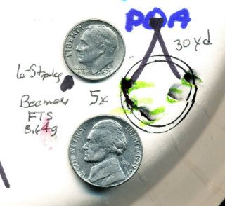

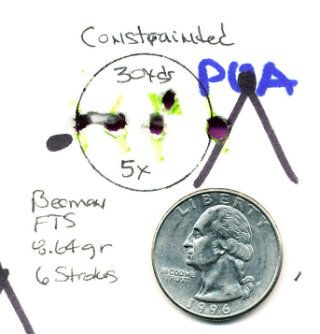

Well, I spent part of the day shooting some 30 yard groups ... wasn't easy.
I was in a bit of a hurry.
Why? The wife was gone and might be coming back soon.
As I was shooting the entire depth of our house and backyard.
From the front door of our garage conversion, through the expanse of the former garage,
onto the utility wash room, out a window, traversing the entire backyard to a pellet stop
suspended on the privacy fence - a full 30 yards.
In-particular, I attempting to verify the pellet drop information I sourced from ChairGun Pro.
As can be seen, something is not ... quite jiving.
Regardless, I was able ... at the very least ... to affirm scope windage and elevation adjustments.
Most of the other 5-shot strings I fired were spread-over an area the size of a quarter.
Some of the groups were slightly less than a quarter.
But, more frequently the groups pushed the bounds of a quarter ... somewhat.
The following photo is the best group of the day.
Standing Position
Hand Lightly Contacting Rolled-Up Support Pad
Rolled-Up Support Pads for Lateral Support of Hands Holding Forearm
Beeman FTS 8.64g
5-Shot String at 30 Yards
After I fired this exceptional 30 yard group, I decided to compose a shot
to demonstrate the parallax problem I'm experiencing.
From the same firing position, I situated myself in a more constrained but well braced
shooting stance.
Then, I had to re-positioned the M4-177 to accommodate how I was standing.
Rather than my head being fully upright, my head was slightly out-of-position.
This situation forced me to hunt for the optical centerline of the scope.
Then, with determination I fired the following string in moderate sucession.
As you can see, the POI has shifted due to shooter induced parallax error.
Using a very compact UTG Bug Buster requires me to look for the optical centerline of the scope.
That is, if my eye/head were not are properly aligned in-order to minimize parallax error.
As such, my head must be in a fully upright position to find the optical centerline easily.
This is why I switched to high rings/mounts ... to make this task easier.

Crosman Premier Silhouette Field Target at 20 Yards
I have a carton of Crosman Premier Silhouette Field Target pellets on-hand.
And, I hadn't tried then out on my scoped M4-177 that is until a couple of days ago.
The H&N FTS pellets I've been using are a very good match with my M4.
But, I wanted to find a cheaper alternative and lighter pellet for greater velocity
and flatter trajectory while still being wind resistant.
I didn't have any expectations the CPSFT.
Well, to say the least, I wasn't disappointed.
The CPSFT pellets did better than I had thought would be.
The following target shows six pellet strikes.
On shot four, one of the pellets unexpectedly strayed from the main group.
This one wayward POI was squarely my fault proven by firing one more shot
that landed within the main group.
The main group of five pellet strikes were under a dime.
And, accounting for the off pellet strike ... still, all under a nickel.
CPSFT 7.9 gr. at 20 Yards
Standing
Forearm Supported by Off-Hand
Off-hand Rested on Rolled-Up Pad
6-Shots, 5-Strokes Compression
As a side note, I wondered how far-off the CPSFT ZERO was from H&N FTS 8.64gr pellets.
Knowing the FTS pellets were heavier, I added an additional stroke of compression
for a total of 6-strokes and sent a few FTS down range.
To my surprise, the extra compression allowed the heavier pellets to effectively have
the same POI at 33ft and 20 yards - a nice added bonus.

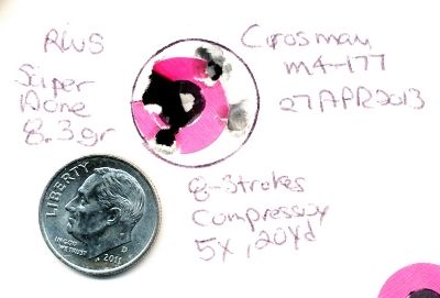

RWS Super Dome 8.3gr Pellet at 20 Yards
Not long ago, I purchased some RWS 8.3gr Super Dome pellets to try-out in my Daisy 880.
My M4-177 shoots well-enough with 8.64gr Beeman FTS pellets.
However, the Crosman M4's are relatively low-powered, low-velocity MSP air rifles.
As such, I was wondering of the lighter Super Dome's might be more compatible with the
performance characteristics of the Crosman M4.
So today, I decided to shoot a few clips to see how well the Super Domes would perform in my M4-177.
Standing Position
Hand Rested on Rolled-Up Pad
5-Shot at 20-Yards
8-Strokes Compression
Very Light Breeze
As it turns-out, the Super Dome pellets did just fine.
One thing I noticed that surprised me ... the 8.3gr Super Domes grouped better under 8-strokes of compression
and less well under a 6-stroke charge.
