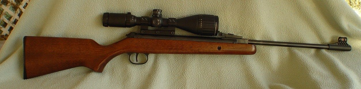

This is my Diana 240 Schütze.
Originally, it was intended for the wife of air rifle tuner John in PA.
However, his wife coveted John's recently customized Crosman pistol/carbine.
So, this little airgun didn't have a home.
After a few emails and some requested changes ... she became mine.
This little Classic had been tuned with John's wife in-mind.
The shot-cycle is smooth, gentle and, as a result, quiet.
The T05 trigger had been set at 1-lb.
Too light for a hunting rifle - I felt.
So, John adjusted the trigger for a 2-lb let-off ... that is just right for me.

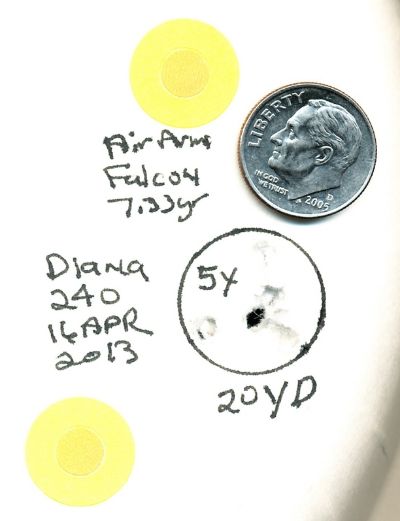

With a Falcon 7.3gr pellet traveling at 500 fps about 4 ft/lbs of energy are available to take care of the task.
As some of you have already surmised, the Classic has been slightly de-tuned from a factory claimed 5.53-ft/lbs (7.5 Joules).
As such, in it's present state of tune ... she's perfect - for me.

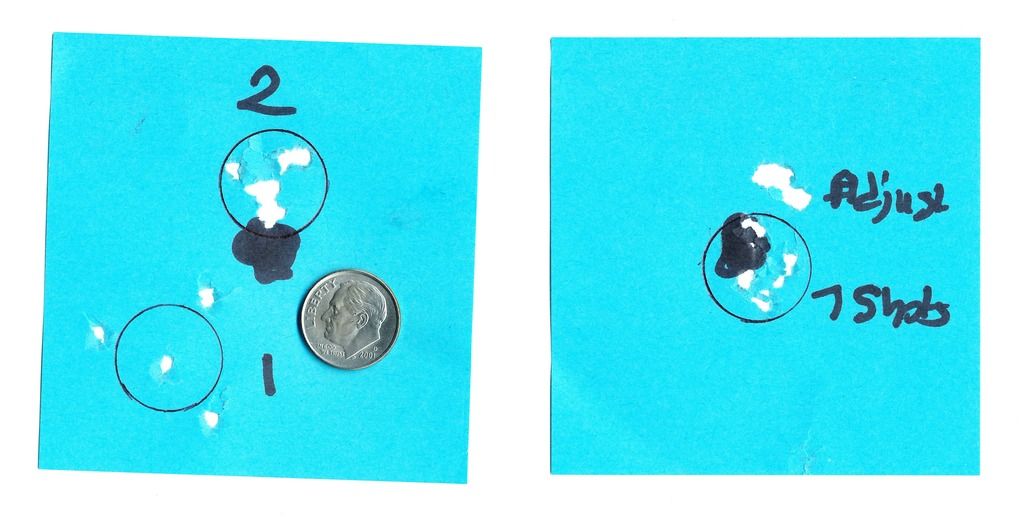

26 Jan 2012, I picked-up my Schütze late this afternoon.
Just had a little time to set a rough zero with the Leapers UTG Bug Buster 3-9x40 AO.
Take a look at the posted note targets that were set 13 yards away.
At the distance I will be defending the bird feeder.
Scope Zeroing Groups at 13yds
H&N Sport .177 FTS 8.64gr
The first group was shot in the standing, off-hand, position with the black dot as the aim point.
It was a quick effort to find where the rifle was hitting.
With the first group, I only let-off four pellets.
I was somewhat disappointed with the group size.
Actually, I was in a bit of a panic ... I couldn't believe the scatter of the group.
I clicked the elevation and windage adjustments to correct zero.
All the while, telling myself to calm-down, use the artillery hold, catch my breath and control my breathing
as I squeezed the trigger.

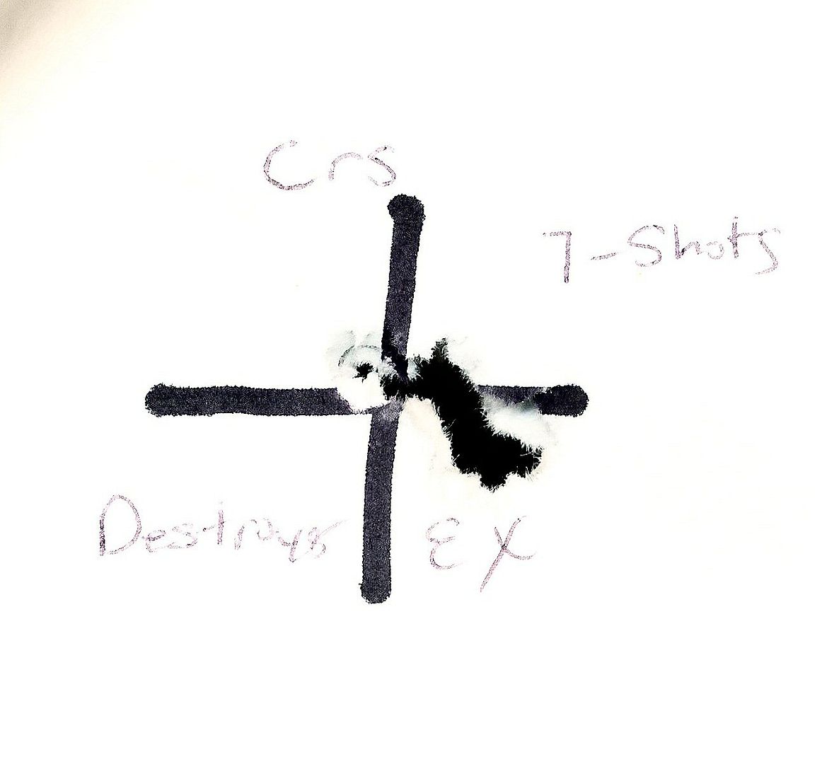

Then, I fired a second group at a slower pace.
It worked ... this group came-in under a dime - as it should have.
I clicked some more correction and shot a third group of seven-shots.
Why seven shots?
As you can see in the third group, the upper-two touching shots indicated more correction was needed.
I quickly clicked the controls some more.
Then, I finished a string of five follow-up shots ... again, all under a dime.
Not bad, I was thinking considering I was not shooting off a bench.
In fact, I had placed myself and shot from the most likely scenario the Schütze will be used in.
I'm confident, with practice, the groups are certain to improve.
As such, I'm satisfied the 240 will get the job of defending the bird feeder done - even
with a 60 year old shooter at the trigger.
Without a doubt, my Schütze is much more capable than I am.

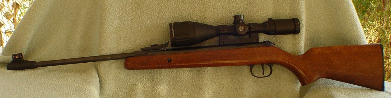

I had to re-zero my scope after I moved it a little further back.
Actually, as far back as possible.
The long length-of-pull places my head further back than I would like.
To better accommodate me, the compact scope and off-set mount
had to be re-positioned as far back as the receiver grooves would allow.
The new locations works better for me.

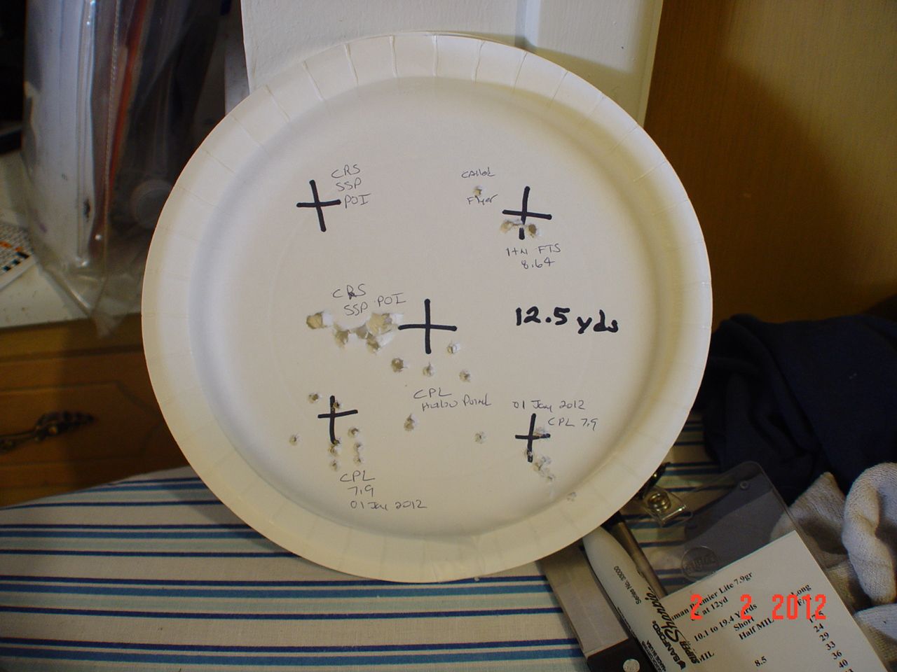

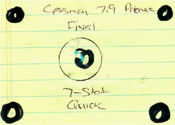

I've already had a couple of tins of Crosman Premier Lites 7.9gr that I used in my Daisy 880.
I shot a few to check whether the point-of-impact was similar.
It is very close.
The Premiers print about 3/32's above the H&N Sport FTS 8.64gr.
The CPL's are round heads and do not cut the target well.
Also, the tablet paper used as target material was not sitting flat against the pellet stop surface.
There are actually 7-pellets inside the outline of a dime.
This group is not indicative of the pellet accuracy in my Schütze.
I sent these pellets down range in a hurry.
I wasn't shooting for accuracy ... just wanted to establish a group center.

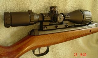

Leaper's Bug Buster Scope and Off-Set Mount
For the last few days, I've been using my Schütze on a daily basis.
As such, the Leaper's Bug Buster 5th GEN 3-9x40 AO Mil-Dot Illuminated Reticle gets a lot of use.
The scope is mounted on Airgun/.22 Bi-directional Offset 1" Ring Mount.
Designed to provide an offset from the base to give extra compensation distance
to the eye relief in addition to what the mounting rail allows normally.
This is a high-mount ... higher than I really need or want.
But, it was the only off-set mount available from Leaper's.
The off-set is required because of the length-of-pull of the Schütze places my eye
farther back from the scope than I would like.
Coupled with the compactness of the scope a mount that would place the scope
as far aft as possible was required.
The scope/mount combo work ... but, a little high.
The illuminated reticle feature is a nice capability - Red (night) & Green (day).
I don't use the illumination much ... but, it is nice to have available as needed.
I've also added the 2-inch shade - sometimes the sunlight is too bright.

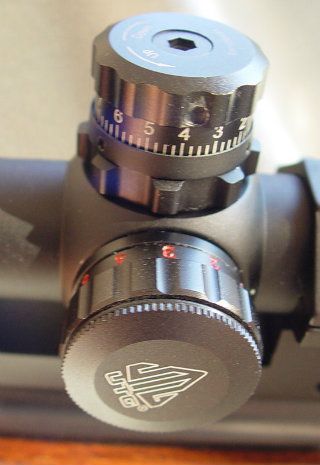

Sighting-in the scope was not easy.
The windage and elevation click adjustments are inconsistent.
Sometimes the clicks are clear, distinct, and certain.
And, at other times, especially the windage ... not so positive.
There were a few times I clicked the windage and noted no change of POI.
Until three shoots later ... the POI would shift.
Also, as I replaced the turret caps while I was firmly securing the caps,
I thought I hear/felt the windage knob click a few times.
Yesterday, while re-zeroing I was very careful with replacing the turret caps
to avoid disturbing the control knobs.
I'm not sure whether I will keep the Bug Buster on my 240.
Keeping zero has been a problem ... unless, my springer technique is the real culprit.
Today, first thing when it gets good and bright, I'm going to re-check zero.
I sure hope zero has not shifted - went through a lot of lead yesterday.
02 Jan 2012/1226H: Just finished a shooting session with my Schütze.
At first I wasn't happy ... the Crosman Premier Lites 7.9gr pointed head pellets
were not printing as well as I would like.
Probably OK for a kid to plink with ... not quite good enough for sparrows at 12 yards.
I continued with the CPL's to check zero ... OK.
Also tried Crosman Premier Hollow Points and Crosman SSP ... not good.
By this time, I was in near panic mode.
I reverted back to the Beeman H&N Sport FTS 8.64gr - all became well.
With the exception of the called flyer ... four-shots under a dime, nearly all touching.
Shucks, I have four tins of Crosman Premier Hollow Points that my Schütze doesn't like at all.
Hmmmm - may be, I can use them for warm-up shots ... for the rest of my life.

I went to Wal-Mart the other day for some .22 caliber pellets.
Well, I didn't exactly find what I was looking for.
In the process, I did buy some .177 Crosman Premier Hollow Points 7.9gr.
Moreover, I bought some Crosman Destroyer EX 7.4gr and All Purpose Hunting pellets 7.4gr.
I didn't have much confidence in some three dollar tins of not-Premier pellets.
But, I was desperate.
I only had half a tin of the H&N Sport FTS 8.64gr that came with Schütze.
As such, I didn't shoot any Destroyers until a couple of days ago.
And, as Ron White might say ... I was wrong ... concerning the anticipated accuracy.
I've been shooting the Destroyer EX's for the past few days at sparrows.
And, I've been satisfied with their performance.
I even accidently loaded one EX pellet backward ... still connected with
the birdfeeder marauding sparrow.

DIANA 240 Schütze: Check Zero
BSA Lightning XL .177: Check Zero ... One Lucky Shot
Well, after the shot with my BSA Lightning XL .177 ... I was feeling cocky.
I decided to check zero on my Diana 240 Schütze.
So, after a one warm-up shot ... I put a pellet on paper.
Pellet Stop Range: 12.5 yards
Standing Off-Hand Position
NOTE: Pink Disk is Smaller than a Dime
Needless to say, I wasn't exactly surprised ... came close.
I continued to shoot ... trying-out a different brand of pellets.
Without much thought, I've gone back to shooting Crosman Destroyer EX pellets.
Reference:
My DIANA 240 Schütze: Check Zero Expand Thread - A.O. Martinez on May 2, 2012, 5:58 PM

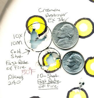

Cool Weather Cold Shot
This morning I was preparing to fire a cold shot from my Hatsan 125 Sniper to check POI deviation for the first shot of the day.
The temperature last night had dipped to 40DegF.
The area where I keep airguns I normally shoot on a day-to-day basis had cooled-off to 50DegF.
As such, my Schütze was cool too.
I had decided to warm myself-up before shooting my H125S by firing a few practice groups with the D240.
Also, I was very curious to see what effect the 50DegF conditions would have on the POA of the D240.
So, I set-up to shoot at 10 meters.
Standing Position Field Hold
Forearm Support by Hand
Support Hand Touching Rolled-Up Support Pad
10-Shot Strings at 10M/33ft
The first shot/cold shot was about three-quarters of an inch low.
I continued shooting to see if the POI would shift back to ZERO.
After the initial 10-shot string, I started another 10-shot string.
By now, Mein Schütze had warmed-up sufficiently and ZERO had returned.

I decided to rescope my Diana 240.
UTG 1" 3-9X50 AO RGB Mil-dot
Zero Lock/Reset Scope w/Rings & Sunshade
Item No.: SCP-U395AORGW
The early version of the Leaper's Bug Buster I originally mounted did not have the ability to set ZERO.
Moreover, I wanted to gain some additional heft to help me steady the light Schütze.
And lastly, I wanted the eyepiece of whatever scope I mounted to be closer to my eye.
A full-size scope would help accomplish some of these goals better than a compact scope.
My full-size Diana 48 and Hatsan 125 Sniper have taught me to appreciate the advantages
of a heavy spring and piston air rifle.
When it comes to holding a steady-shot and the follow-through needed for accuracy with a springer.
The ability to zero-out the turret caps have been a tangible asset.
Especially when trying-out different pellets.
The ability to set-zero with another style or brand of pellets and be able to return-to-original-zero is very helpful.
I left the rear sight on for no other reason than I didn't have any filler screws to fill-in the open holes
on the breech block.
But to my surprise, the rear sight is not visible in the field-of-view.
About the only real problem is the flip-up scope caps cannot be used.
But, neither can the extended sun shade - even with the rear sight removed.
So far, I haven't experienced the need for either.
I forgot to mention, the scope is illuminated Green/Red.
And, the turrets are ZERO-locking by an over-sized castellated ring-nut at the base of the windage
and elevation turrets.
Setting the turret cap to zero and locking-zero can be a little tricky and requires a little practice to get
the sequence down.
So far, I've become satisfied with the way my 240 now handles.
The additional weight of the scope and one-piece mount really compliments the feel of my Schütze.
The Leaper's optic does seem a little large.
But over-all, not to the point of being perceived as out-of-place.
I had considered mounting the next size smaller scope version - the one with a 40mm objective.
UTG 1" 3-9X40 Full Size AO Mil-dot RGB
Zero Locking/Resetting Scope
Item No.: SCP-U394AORGW
But, the forty objective would have required the same high mount - thus, no advantage going 40mm.
I'm thinking, better to use the clearance between the barrel and objective to good use with more glass.
I did encounter one problem with the scope swap.
Apparently, my 240 does exhibit some barrel droop.
The scope elevation is within a full turn-and-a-half of running out of elevation adjustment.
Reversing the single-piece mount changed little.
Since my 240 is slightly de-tuned, I don't think the recoil being generated will damage the erector mechanism.
Even so, in the near future a droop compensating mount will be in-the-works.

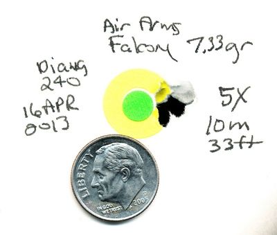

Air Arms Falcon 7.33gr Pellets
When I purchased my Diana 240, the rifle had been tuned by John in PA
using Air Arms Falcon 7.33gr pellets.
Unfortunately for me, I couldn't find anyone stocking these little pellets.
Now, I've finally been able to obtain a couple of tins to try-out in my Schütze.
With the first few try-out groups ... I was impressed.
So I settled-down for a 5-shot string at 10-m (33-ft) - I wasn't disappointed.
Standing Position
Off-Hand Supporting Forearm
Off-hand Resting on Rolled-Up Pad
5-Shots at 10-Meters (33ft)
Air Arms Falcon 7.33gr Domed Pellets
Calm Wind Conditions
After this group, I set-up to fire some groups at 20 yards.
I really didn't expect much.
But, I knew that round-head or domed pellets fair better at longer distances
than wadcutter pellets or flat-head pellets.
The following is the best group I fired at 20 yards with the Falcons.
Standing Position
5-Shots at 20-Yards
The round-head pellets do not cut the target cleanly.
Even so, Look closely and you will see five pellet strikes.
I shouldn't be surprised by these results since John in PA was employing AA Falcons
in his testing of this 240.

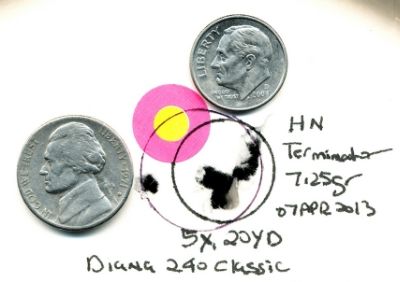

H&N Terminators 7.25gr at 10-Meters and 20-Yards
I had the opportunity to fire a few groups with H&N Terminators 7.25gr pellets.
At first, I fired a few groups at 10-meters to access the short-range accuracy of the pellets.
I was firing quickly since there were some gusty winds present.
As such, spending too much time and effort to carefully aim probably would not be rewarded
with great precision because of the winds.
So, I made a casual effort to form some groups.
Even so, the final group situated above the nickel and dime proved to be rather satisfactory
considering the conditions.
All considered ... Not too bad.
Standing Position
5-Shots at 10-Yards
H&N Terminators 7.25gr Point-Shaped Nose, Hollow-Point with Pin-Point Center
Unpredictable Low-Wind Gusts
So, I set-up a fresh target at 20-yards and began to fire away.
I was presently surprised to see the a good group forming-up.
That is until shot number 4 ... landed way-left of the main group.
I attributed this near miss to the wind conditions as shot number 5 impacted within
the main group.
Standing Position
5-Shots at 20-Yards
