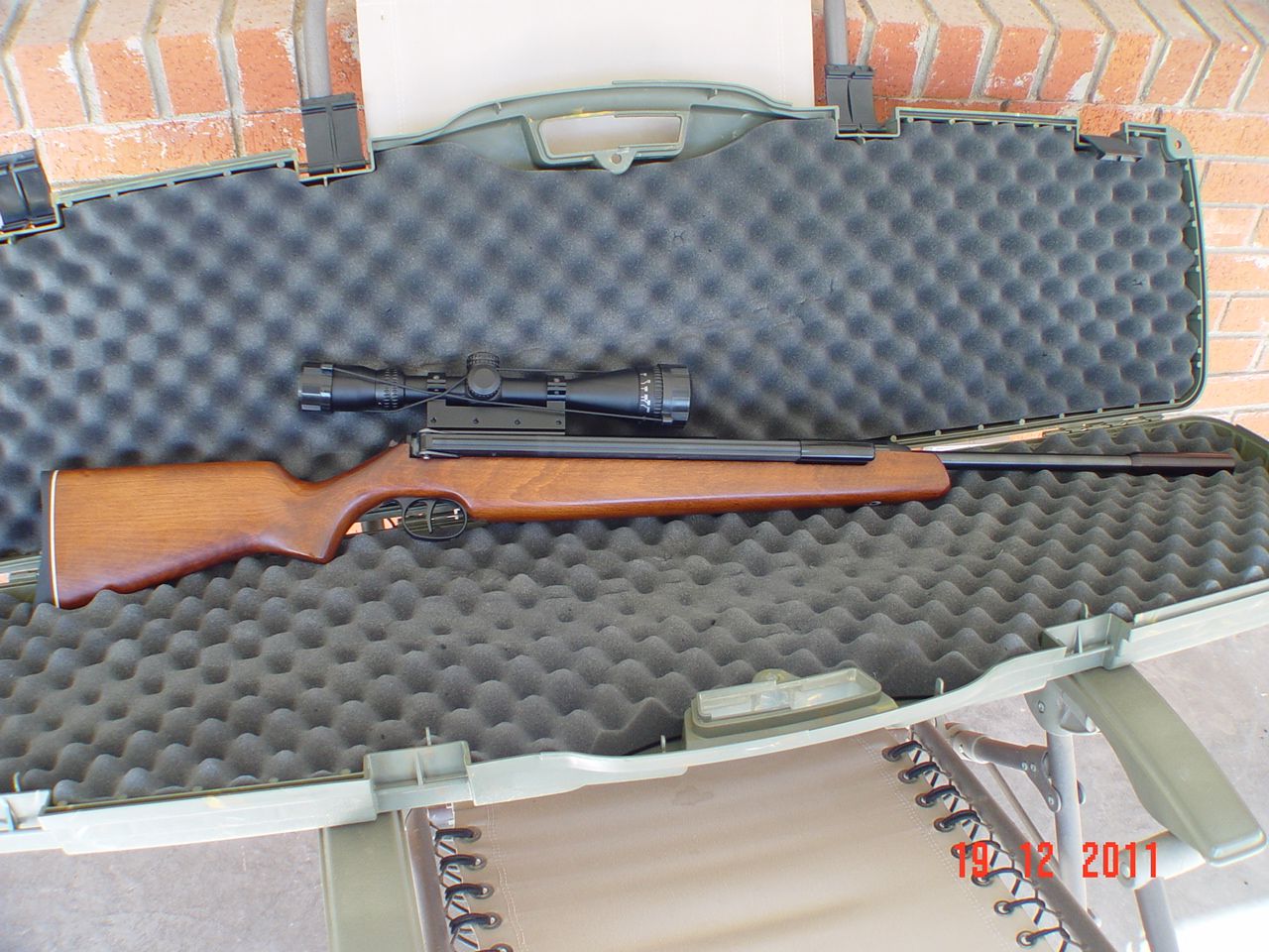

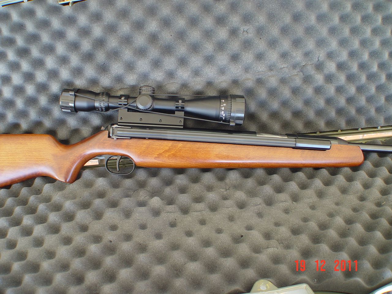

I recently purchased a quarter bore air rifle.
Big Medicine: VORTEK Custom Tuned Diana M48 .25 Cal
Here's a few photos I've taken.
My initial impressions: this is a heavy man-sized rifle.
Rifle, scope and mount weigh-in at an unexpected 10.2 lbs.
And, in a standing firing stance ... my muscles felt every ounce as I struggled to hold steady on-target.
Not a easy task.
As I became fatigued very quickly.
In contrast, the trigger-pull was very light.
So light that the first shot went-off unexpectedly ... I was surprised.

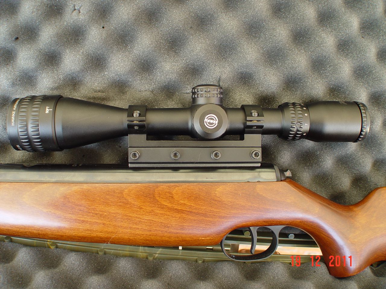

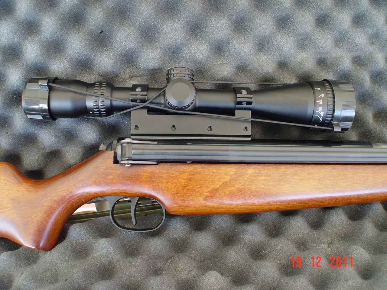

Hawke Airmax EV 4-12x40, Map6 Illuminated Reticle
Muzzle Mac muzzle brake installed by 2nd owner ... really a muzzle weight

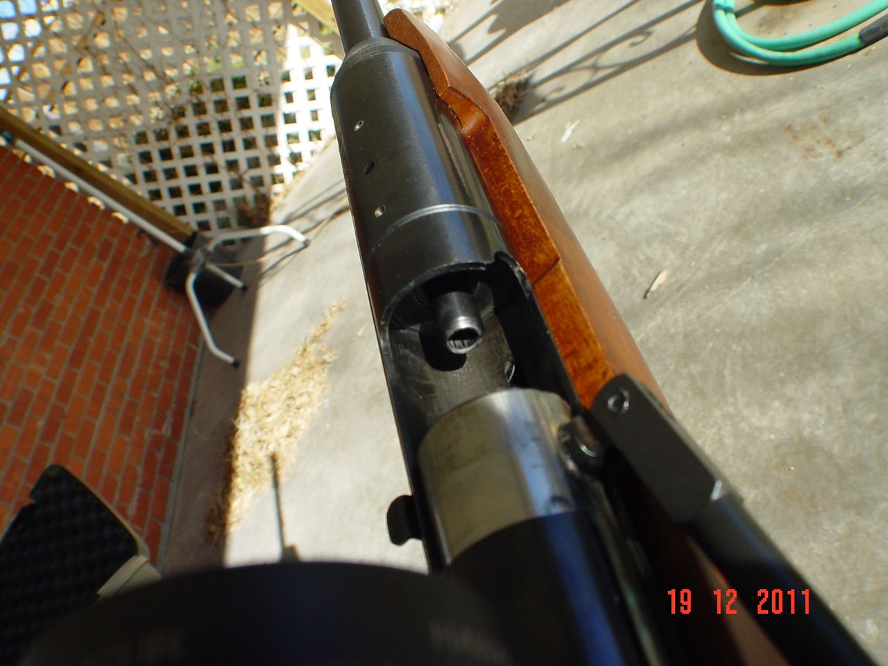

Barrel breech opening is huge ... very easy for a oldster to insert an equally large pellet.

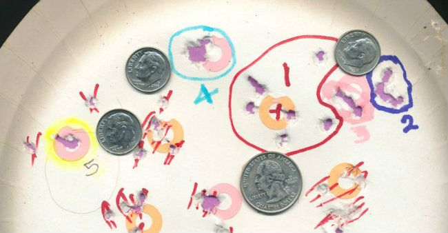

But, I did fire-off a few more rounds - as is without regard to scope zero.
My target was a posted note with a black-dot scribbled in the center.
As can be seen, there are three large holes above the single dot.
Horizontal stringing to be sure ... three different grips.
Please note the shot string is near linear.
Vertical shot placement is very close - not much deviation ... very heartening.
By the way, the last hole on the right was a called flier ... pulled-the-shot.

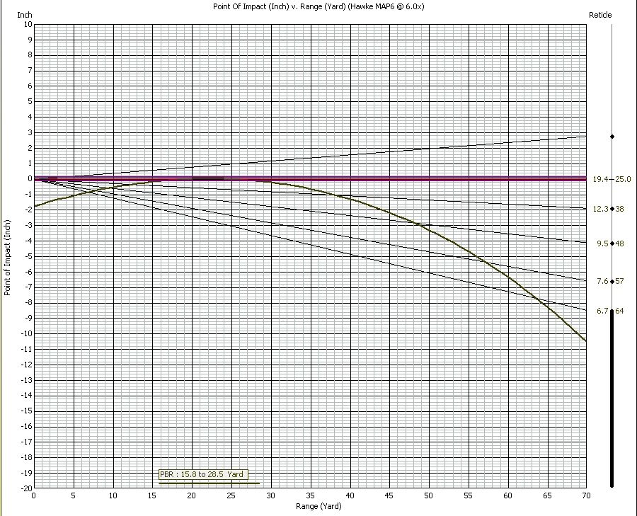

Zero Set: 25 Yards or 2nd Dot Aim Point at 12.3 Yards
I took the time to set zero today.I've had some practice with my Schütze - sure helps to have a trainer.
This was shot from a window sill at a distance of 12.3 yards.
Why 12.3yds? This is the range indicated POI for the 2nd-dot of the MAP6 reticle.
Now, the reticle cross hair will be zeroed at 25 yards.
With this zero the point blank range of a 1/4-inch kill zone will be from 15.8 yards to 28.5 yards.
This is more than enough for my backyard.
The shortest shot I anticipate might be 8 yards.
I expect that the most likely range will be from 10 to 12 yards - 2nd & 3rd MAP6 reticle dots respectively.
It wasn't hard to walk-on the reticle to the aim point.
As a point of interest, the 1st group was on the lower left hand side and consists of 5-shots.
A two-shot group established POI at approximately 3/4-inch off-center at 12 o'clock.
I clicked some correction.
Then, fired two more shots.
Dialed some more correction and the last shot of the string is just to the left-of-center.
The 2nd group is the one on the upper right hand side.
The dead center of the circle was shot-out by the first three pellets I fired.
This created a black hole for an aim point.
As such, I lost the 2nd MAP6 dot (indicated 12.3 yds) ... resulting in the group opening-up.
Even so, the group could be still be covered by a dim.

Please note the size of the 5-shot group is dime sized.
More significantly, the majority of the shots are touching with one pellet blowing a separating remnant away.
This was done without any warm-up shots on my part.
However, I did fire one random shot to loosen-up the M48.

I'm going to buy a set of shooting sticks.
A tripod system for the backyard.
And, a mono or bipod for field use.
Lately, I been using a makeshift shooting stick that I improvised from a push-broom handle.
It works.
But, it is not as steady or as easy to use as I would like.
Even so ... it helps.

Old 08-25-2012, 11:43 AM
4,681
Check Zero ... Re-Zero
It's been sometime since I checked zero on my M48.
But, it seemed about time.
As my wife spotted some unwanted trespassers in our backyard - time to prepare the M48 for action.
As it happens, I've been shooting my Schütze and BSA XL Lightnings with great regularity.
I wished I could say the same for my M48.
But, like a hi-powered rifle, the M48 is only uncased ... when there's serious work to do.
So, time to check zero.
Since the last time I shot the M48, I've adjusted/changed my shooting technique and rifle hold - somewhat.
And, it showed as I started printing some groups.
Shooting Distance at 12.3 yards.
For reticle to be zeroed at 25 yards.
NOTE: Red-X'd or Red slashed holes are .177 pellet impacts
I was not sufficiently motivated to set-up a new target
In hindsight ... I should have
My plan was to shoot 5-shot groups until the M48 was zeroed.
Group 1, circled in red, are 8-shots that were way-off mark.
The rifle was dieseling badly ... the first 2-shots extreme hits to the right just inside the red meandering
circumference were the result.
As the dieseling began to subside, I continued shooting until some semblance of clustering began to form-up.
Group 2, marked in violet, was still dieseling, but, much less so.
The stringing was evident because I was trying to settle on a more comfortable hold.
The M48 is a heavy rifle ... it pays to find a comfortable hold for slower shooting.
At this time, I decided to make some scope adjustments.
Group 3, delineated in pink, the dieseling had subsided significantly - no more obvious smoke.
But, as I opened the breech I could detect the faint scent of dieseled smoke.
I made another set of scope adjustments.
Group 4, denoted in aqua, was the result of a more deliberated effort on my part.
I didn't shot fast ... I certainly didn't go very slowly ... about ten to 15 seconds per shot.
I performed another fine scope adjustment and settled-down for another 5-shot string.
Group 5, noted by highlighter, was not a 5-shot group.
It is two pellets stacked one on top of the other - or, nearly so.
These last 2-shots were enough for me to be assured my scope was properly zeroed.
I decided to leave well-enough alone ... recover the target and post my doings.
