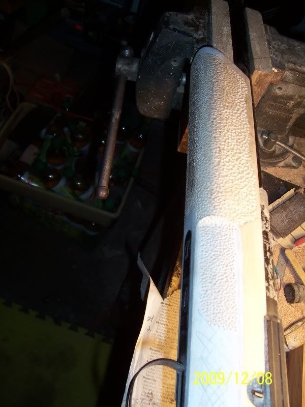

Carbide and diamond burrs compared
LH burr is diamond, RH is carbide. Both torque to some degree, as you may see from the oblong cut. Carbide burns much more easily.
Notice the burn on RH side.
Notice the shadow from the uncut wood on each, LH side. Carbide leaves more uncut.
Carbide set cost $50 in 1976, Diamond set cost $6.00 last week.
LH side of stock, larger burr used on forearm, smaller in indented area.
Rh side. Glue lines disappear.
This work is somewhat boring to perform, so do not let your mind wander...leads to staying into areas of the stock you wanted to leave uncut. I only work for 1/2 hour and stop. Do a little each night until finished
