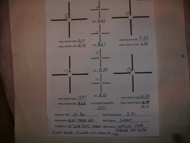

Like I told you it may not work in every rifle but to say it flat does not work is wrong. I havew seen a number of people post that it worked for them, Fuzzy Limey has been using some version of it for over 70 years!!
Just because it did not work for you does not mean . Look at this:
My 10/22 African Rose it tape bedded and it shot these @ 50 yds.:
That is four groups at 50 averaging .228" with tape bedding that is at least 6 months old.
You say it does not work because it flexes yet you recommend Dip It which is SUPPOSED to flex!!
The tape has worked for many people. If it did not work for your rifle using it your way only proves your method of applying did not work. That is when you should try another method.
I showed you how I used it on my Rem 581 (round action). In our conversations you seemed very confused. I spent a fair amount of time trying to help but it seemed like you just would not get it.
You did not like? Fine. You could not make it work? Fine! But do not go running around going on about it will never work when so many people have had such great results for YEARS. Your one example does not mean many, many people that did it right and got good results are wrong and you are right

WOW!! - I need to find some lipstick and tape my 10/22, great shooting

Thanks the rifle is coming along nicely.
