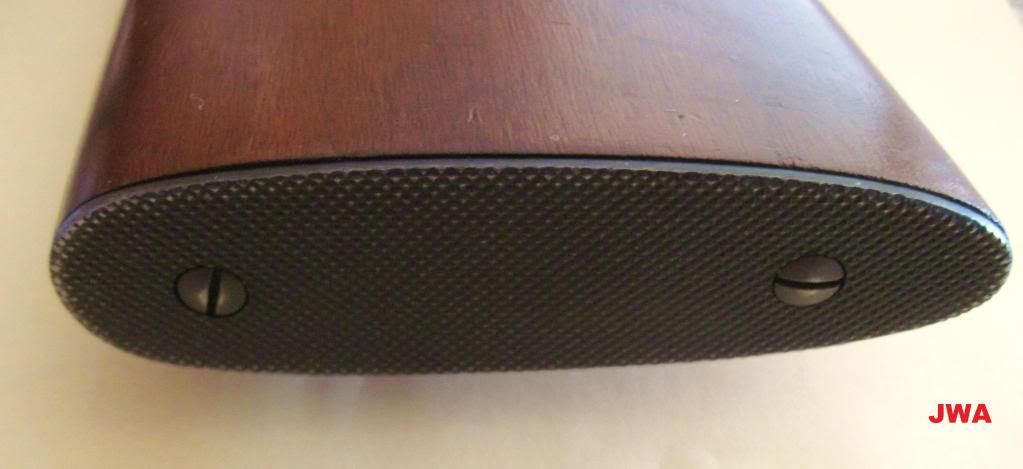

The stock for the Model 56 is clear American black walnut with an overall length of 26 5/8” and fitted with a blued flat steel checkered buttplate. The standard stock was smooth with no checkering. The “Fancy Sporting” rifle had a checkered stock and slightly fancier walnut. The forend has a very graceful taper culminating in a classic Schnabel tip and is one of the few Winchester models offered with a Schnabel forend (the Model 1904 and the Model 54 being the other notable exceptions). The finish is a clear lacquer type with a semi-glossy sheen. The 56 stock was not equipped with sling swivels.

Additional Photos -
