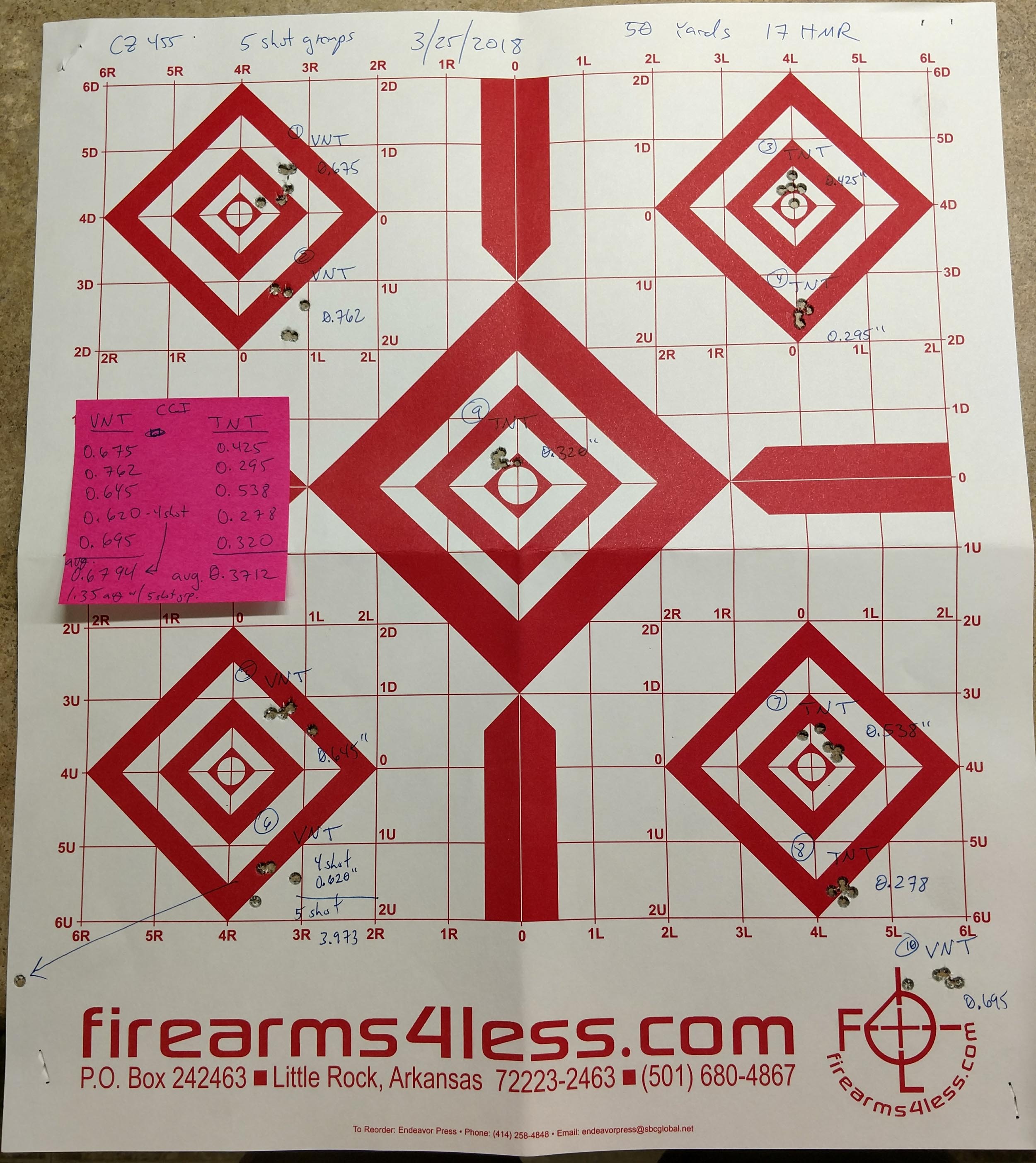

I fired my VNT (lot # M07Y302) today for the first time, and like Keith, the results were terrible -- perhaps the worst I've ever seen from any 17HMR ammo I've tried. Maybe it was a bad lot. Keith -- Is yours the same lot#?
I was going to chrono it, but the accuracy was so bad that I didn't bother as I'm not using it if it was not at least as accurate as my go-to -- CCI TNT.
Have a look at photos linked to above. One shot was over 3" away from the group.
TNT
.425
.295
.538
.278
.320 avg: 0.371"

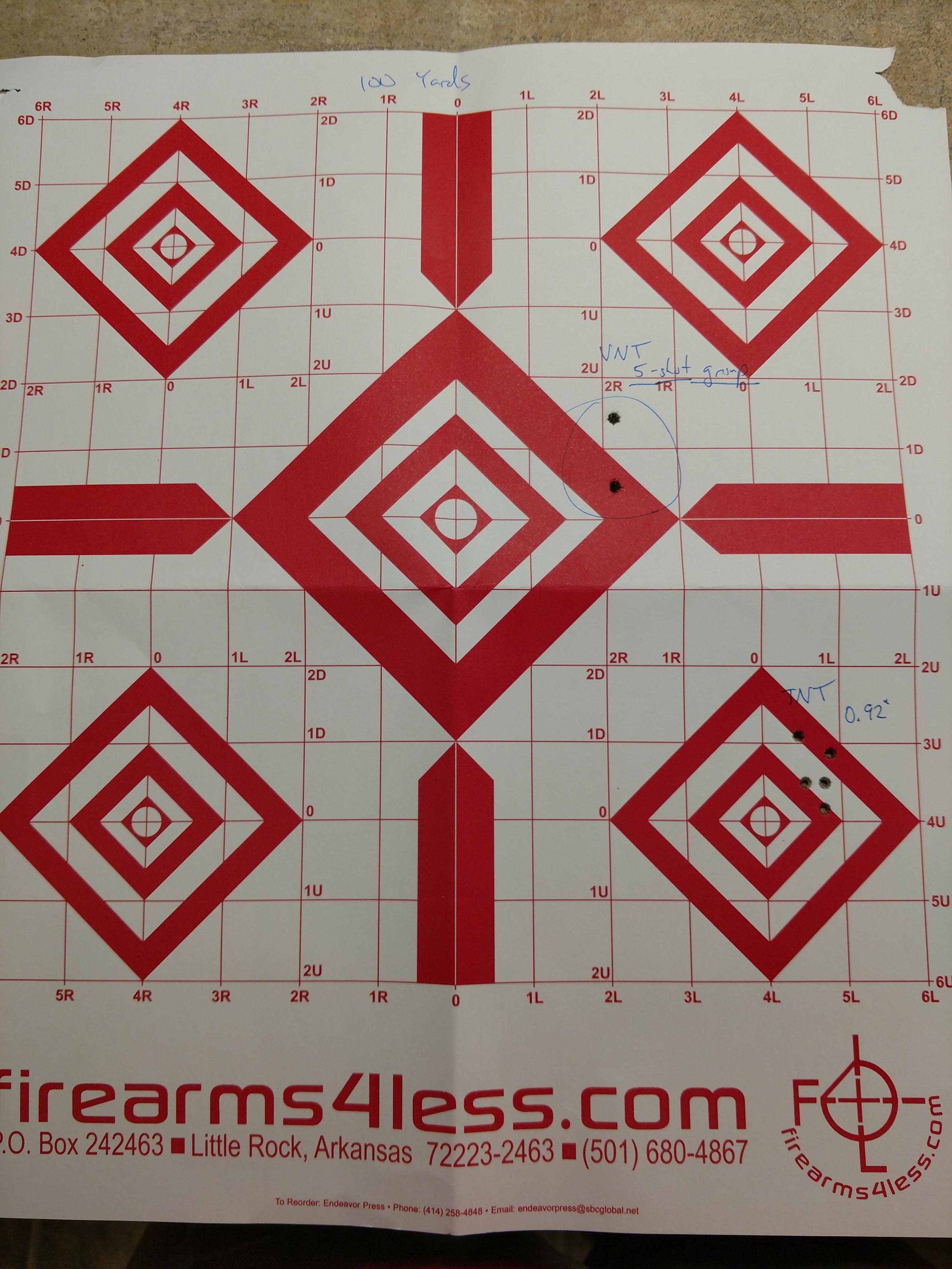

100 yards:
For grins, I wanted to see what the VNT would do at 100 yards. I shot one group. Point of aim was center diamond. ONLY TWO SHOTS MADE IT ON PAPER. There seemed to be a different sound/report with some of the shots... maybe they were grossly over (or under) powered.
I immediately shot the lower right group with TNT -- measuring 0.92" -- about what I've been getting.

If you'll notice in the photos of the paper targets in my previous post -- the holes with the TNT is noticeably 'cleaner' than the one with the VNT. The VNT produced more ragged holes. I'm not sure what to make of that but I doubt it's due to the tip of the bullet (i.e., one being plastic and one being an HP).
Perhaps the VNT bullet is wobbling/yawing some. That might explain the poor accuracy.
