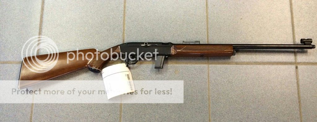

I am starting to see how people can become gunaholics. I saw another Gevarm advertised by a gun dealer here in the UK and, of course, bought it.
I could hardly NOT have bought it at the price - 45 ($70)!
It's another E model but this one has the iron rear and fore sights that were missing on both of the first two that I bought although it looks like the rear ramp may be missing here. The ring for the threaded muzzle is also apparently missing. Once again this was bought sight unseen, just a photo and the assurance that the barrel was in good shape were enough. There's an 8-round mag though.
Condition of the wood looks to be very good from this photo.[IMG][/IMG]
Anyhow, it's mine now and I'll give you all the lowdown when I clap eyes on it and the others. Soon now!

70.00!!! Wow, sweet grab! Looks like an E-2 deluxe with the checkered wood, tangent sight and threaded muzzle. You definetly have the wide forearm on that one. It might be an E-3 but I can't tell as I never seen a true E-3 before. When you get that gem in hand, let's get a look at the magazine, it may give a clue if it might be the elusive E3. The E3 is suppose to have the last magazine design. I have a magazine so we should be able to figure it out quick. Thanks for posting this, it's nice to see some of the later/last GevarMs as they don't exist over here.
