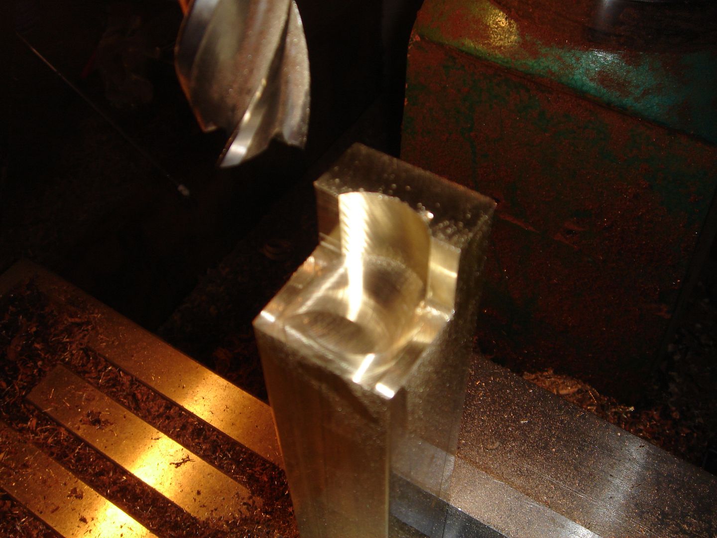

Original Ruger 10/22 design should be looked at first... The original 10/22 was a dual bolt rail guide design - in all old serial numbers without a prefix thru prefix 110-xxxxx... Some prefix 111-xxxxx still keep the dual rail...
The rail is about .085" deep on the eject side and .045" deep on other just over the .485" width of the bolts top...
These rails are machined into the top inside to guide bolt... Newer receiver have only one guide rail which allows the bolt to skid sideways when extractor spring pressure is applied to the barrels extractor cut... Skews...
Problem back than was the Ruger bolts were machined cruder and heavier than modern bolts and a dual rail required tighter tolerances so bolt would fit and not bind... With one rail - machining tolerances could be opened up... Better suited to a mass produced $40 rifle...
If I was making a receiver I would return to the dual bolt guide idea so the bolt can only go back and forth straight with no side skew... I might even lapp it in, hehaa...
I see all the aftermarket receivers... They all copy the modern Ruger and don't seem to do anything for a accuracy increase... The key cutter operation just under the ejection port is crucial to bolt support... RAZOR seems to be the best in this area, tight without binding, just nice... Others 'keycut' too large and the bolt dangles downwards relying on the magazine to hold it up in the forward postion and the trigger group body to hold it up when in back position... Just slop...
The dual rail design does use a more aggressive ball mill cut to fit the bolts guide rod but ball mills are cheap... Looks like a common 1/4" dia long flute ball mill will do... Borrow a old 10/22 receiver with above serial numbers and see... I bought a receiver a few months ago here on RFC knowing with a 110 prefix it was the 'one'...

I really appreciate this valuable input! I had already realized the key cutter operation on the ejection port is going to be the most critical and maybe hardest to get right. I hope to make the tolerances as tight as possible and then open them up as needed for reliable operation.

Yes, this alloy is about 63% copper, and I've thought the same thing, but I can't imagine ever using a copper solvent on a .22. That said, I actually checked the owner's manual for my brass-frame Henry Mare's Leg before I bought the material, and, interestingly, there is not a single word of warning about using copper solvents.
