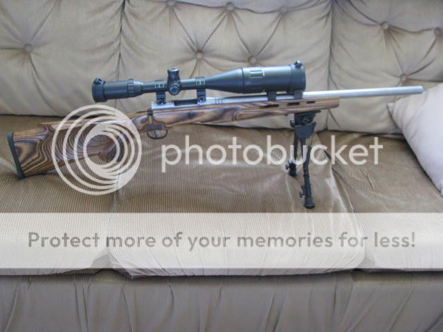

My HB SS Bmag came with the crappy plastic stock also and the very first thing I did was put a Boyd's Pro Varmint on it. I bought my stock from DIP Inc. because they had one already in stock and I didn't have to wait. I also bought the all metal trigger guard from DIP Inc as well. It's much nicer than the crappy plastic trigger guard they come with from the factory. I'm not a fan of two piece scope mounts so I got the one piece picatinny rail from DIP Inc too. Dip Inc usually has everything in stock so there is no waiting, but, if you want a specific laminate pattern, you'll have to order it from Boyd's because all DIP Inc has is the black ones.
https://www.diproductsinc.com/Default.aspx
When you are ready to swap your stocks, it's VERY important you remember to remove the escutcheon from you old stock and put it in the new stock. I found 18 in.lbs of torque on the action screws to work the best for me.
This is how my Bmag turned out with all the above parts and maybe one of two other pieces as well.

To my eyes, the barrel rings as well as the fugly bolt handle on my Bmag was just a little more than I could bear, so one of them had to go.
The bolt handle on my Bmag started life as a bolt handle from Glades Armory that they sell for the Bmag, but, for some reason Glades Armory thinks the bolt knob needs to be crazy extra large and not only does it hinder your finger from getting on the trigger but IMO it just looks stupid being so large. I had my gunsmith cut a little off the end to shorten it, as well as, he turned down the outside diameter in his lathe. It works pretty well now and doesn't look so silly.
I don't exactly recall which scope rings I used, they are either Burris or Weaver, I think. lol The nice thing about using a once piece picatinny rail is it gives you LOTS of options for scope rings as well as location of where you mount your scope. I think a one piece rail also adds rigidity to the action as well.
Also, I'm not sure how much you've read about the Savage Bmag, but if you've read much about them at all or if you've ever handled one, you already should know, they are far from a high quality gun. The HB models seem to generally shoot well, but high quality they are not. In fact, I would have to say my HB SS Bmag is EASILY the lowest quality gun I've EVER owned and I often refer to mine as the gun I love to hate, BUT, the dam thing shoots crazy good and I've actually grown to like it, a lot! I've shot sage rats with it out to some crazy far distances and once I got used to it's oddball quirks, they don't seem to bother me much.
Soooooo, if you didn't know before, you do now, so don't be like some that have went ahead and bought one of these things, get it, then come back on here and talk about what a low quality POS the Bmag is.
