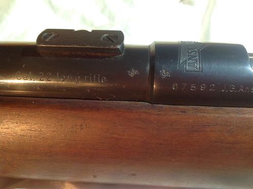

Toomany22s's Avatar
Toomany22s is online now
Sep 2017
Hoosierville
8,447
Like this ?
File Type: jpg A450845E-4FF6-4811-A977-F9D82A084DD2.jpg (507.6 KB, 11 views)

Originally Posted by Penage Guy View Post
Although these logos may be of limited use when it comes to rifles with relatively early serial numbers, these may be helpful for a general idea of the date of manufacture. Some of the 1955 logos appear across the receiver, while others are placed in line with the barrel. The latter alignment is more recent, but when they were turned to line with the barrel is not clear.
Like this Photo
Thanks guys
