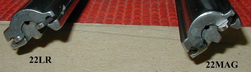

Since this is asked about repeatedly and has been answered in numerous threads, here it is in a nutshell.
1. Any wooden stock inletted for a 77/22 LR, 77/22 Magnum or 77/17 are interchangeable. The pictures shown below are of the same stock with a 77/17HM2 action and a 77/17HMR action in place. The receivers are the same size, the only difference is the trigger guard lengths.
The only difference between a 77/22 LR bolt and a 77/22 Magnum bolt is the groove length that is machined in the bottom.
There is No Difference in the cartridge guide, Nor in the bolt face.
I measured the recess depth and the distance across the recess on both of these bolts and they are identical. If your going to build a switch barrel rifle, you will need either the Magnum or LR trigger guard which you can purchase from Ruger or Brownell's in the finish that is the same as your receiver. It is easier to do if you start with a LR model. If using the Magnum model, you have to file down the ejector on the trigger guard to get the bolt to close.
If you have a instruction manual, it lists the appropiate part numbers, if not here they are.
Magnum Trigger Guard, Blued J30201 SS KJ30201T
Magazine Well Liner, Blued J00600 SS KJ00600T
Front Mount Screw Blued J04700 SS KJ04700T
Rear Mount Screw Blued J04800 SS KJ04800T
Magazine JMX-1
You can use a Ruger barrel or one from Green Mountain, Volquartsen, or any number of suppliers.

groove length
O.M.R.
i think you have the labels reversed for the grooove length. longer groove for the magnum. don't know why they don't just cut 'em all long. would save me opening them up with a dremel and filing down the ejector tit on the trigger guard when I do a rebuild.
Old 08-04-2007, 08:19 PM
Ole' Man River
US Navy Veteran NRA Member - Click Here To Join! GOA Member
Jan 2000
4,019
93% (24)
Originally Posted by patience0830 View Post
O.M.R.
The bolt on the left is most definitely from a 77/22 (LR) Long Rifle receiver. I just pulled my rifle apart to verify it. The numbers on the bolt and receiver match. Rifles with the 702- prefix in the serial number are LR rifles. Perhaps you might want to check the numbers on your bolts and receivers.

I've done this swap myself, taking a stock .22LR to .17HMR - Ole Man River's info is right on!! This swap is very easy and this post gave me the push to make my desire a reality.
Some notes: in the pictures above showing the groove length on the breech blocks, they are mislabeled. It is actually the Magnum bolt on the left and the Long Rifle bolt on the right. It isn't a big deal really, but can be some extra work depending on the direction you are converting. A magnum to LR conversion would require less work (no bolt grinding) than would a LR to magnum, as evidenced by the shorter grooves that need modifying to work with magnum hardware.
Also, the rifle I modified is a 1984 77/22 LR, and the stock was inletted for the LR-length trigger guard, but hung up on the magnum-length trigger guard. This only took 10 minutes with some chisels to remedy, but is another point to consider. I am not sure if LR stocks are inletted differently than Magnum stocks today, but this could be something to expect on older rifles like mine.
That's all I have to say. Conversion = easy.
