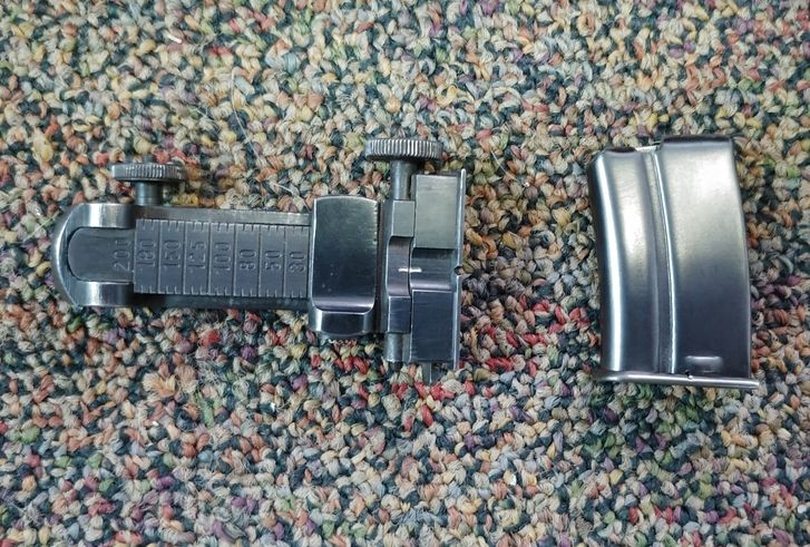

From the link above, post #19 had me more curious for obvious reasons.
Here are some more pictures, including the first below, which is one of the previous photos blown up to show the serial number, albeit not very clearly.

Those last two bits alone are worth $500-$600, or more.
