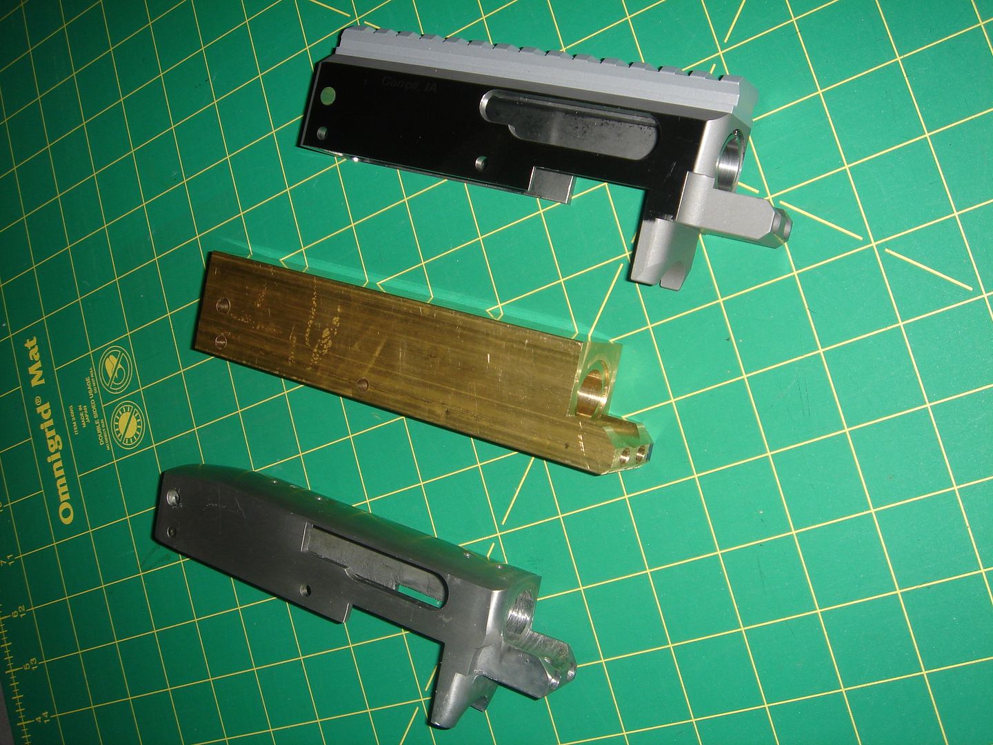

I JUST COPIED THIS FROM THE NEWER THREAD

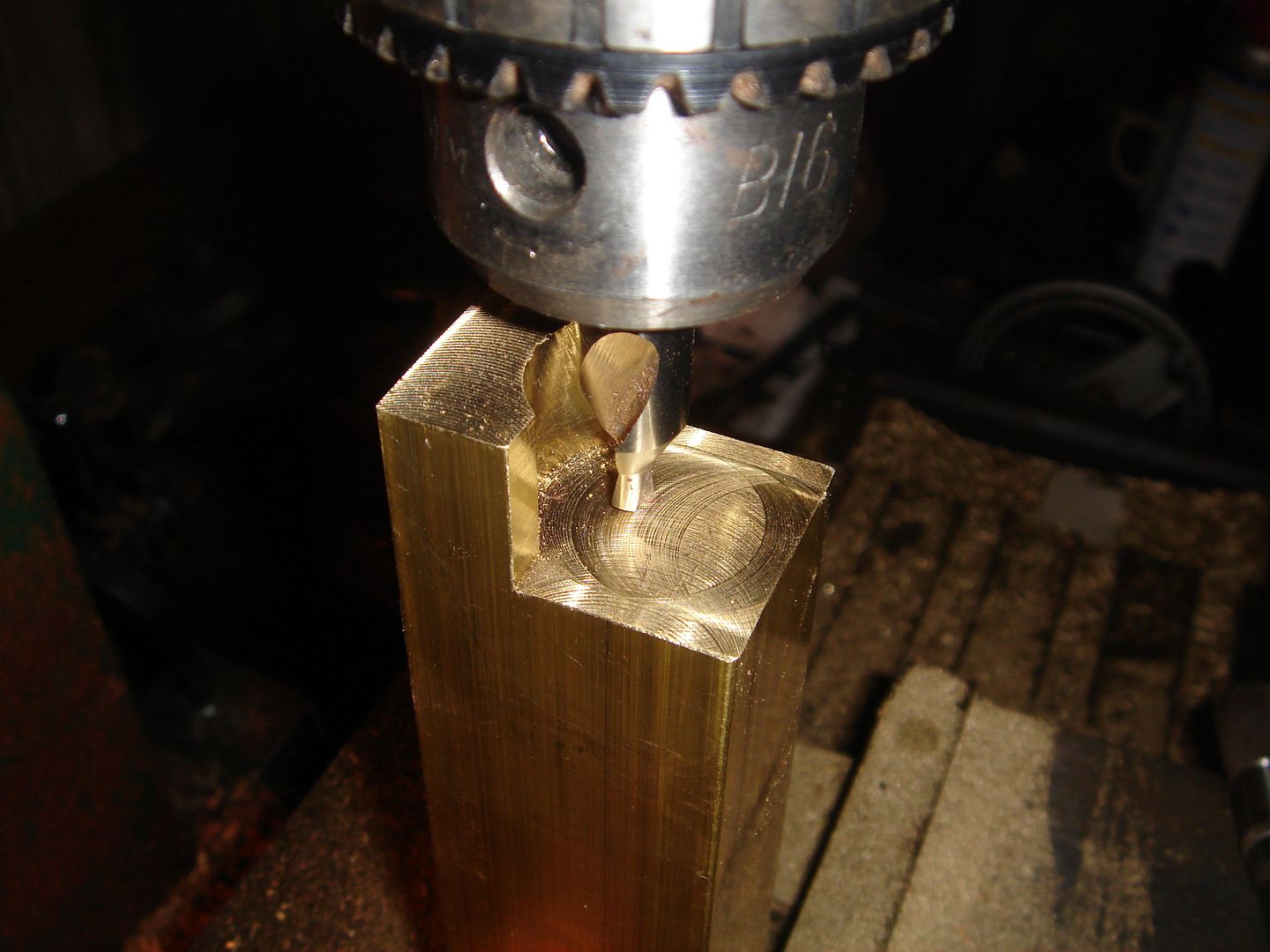

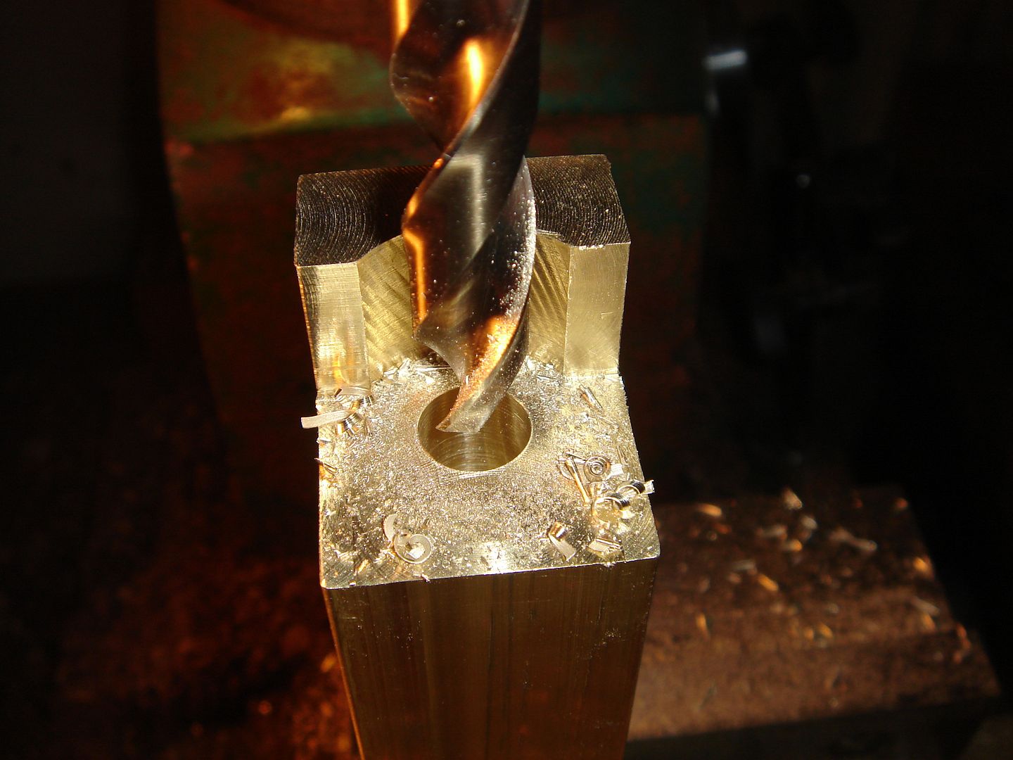

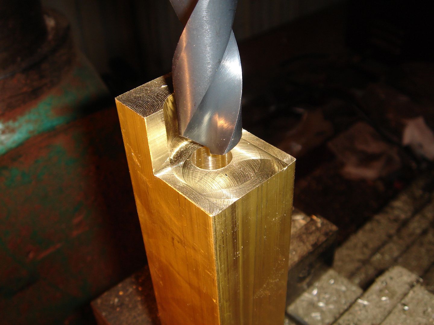

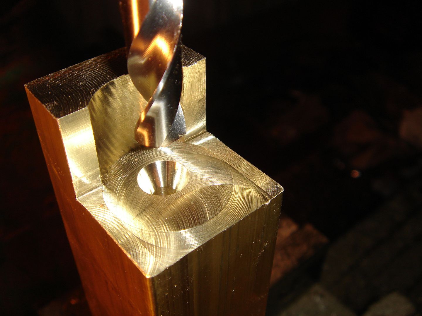

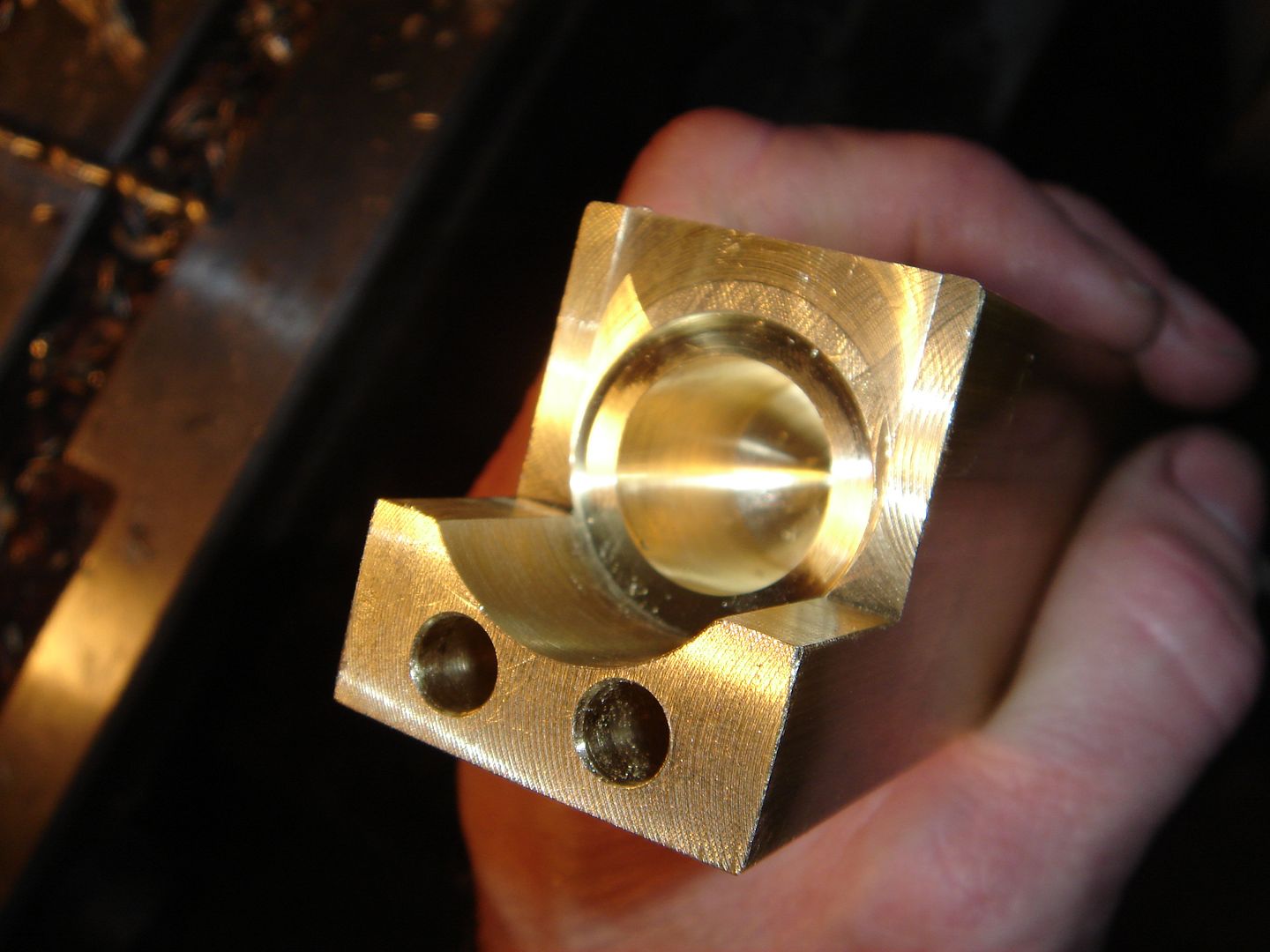

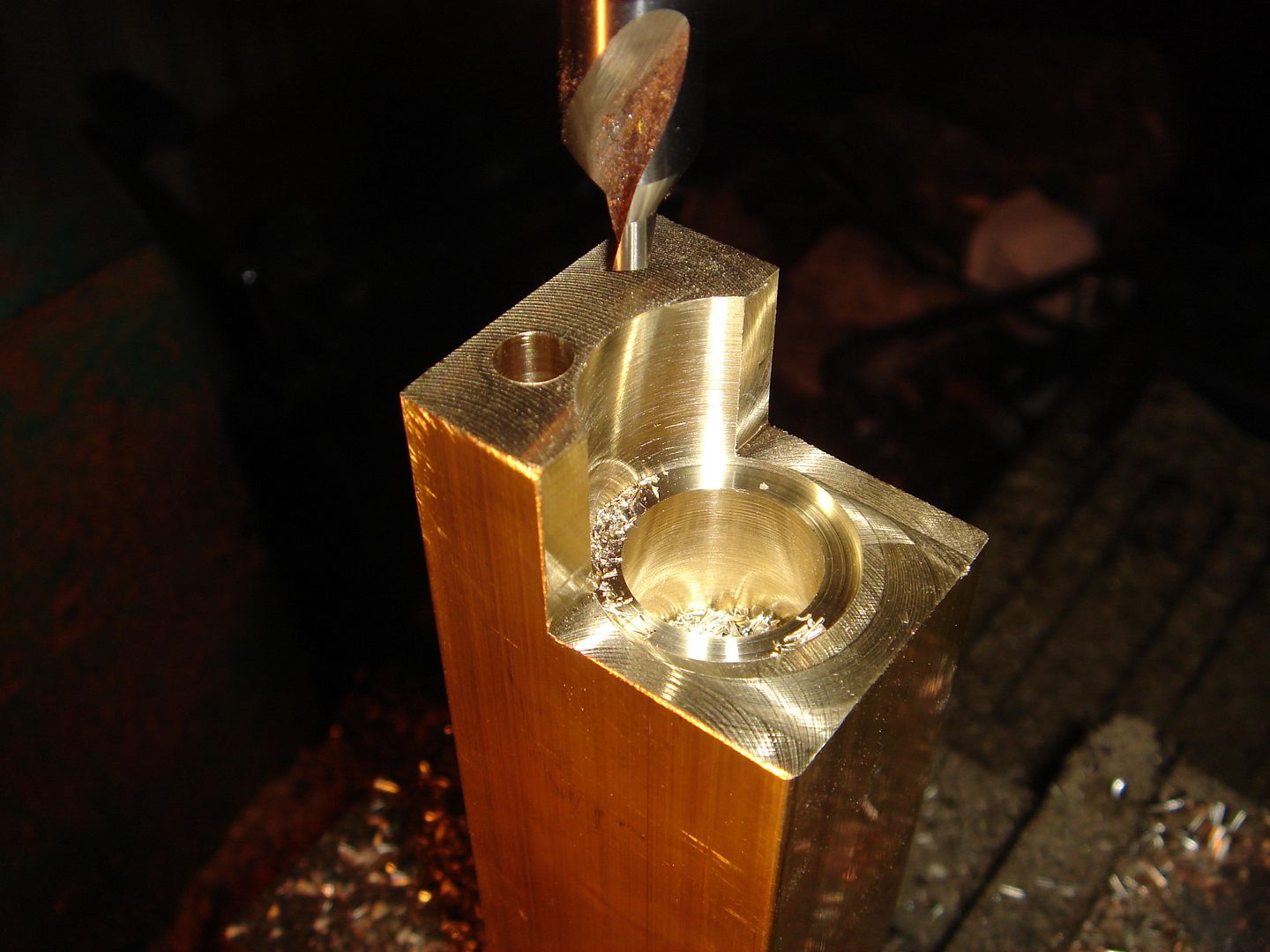

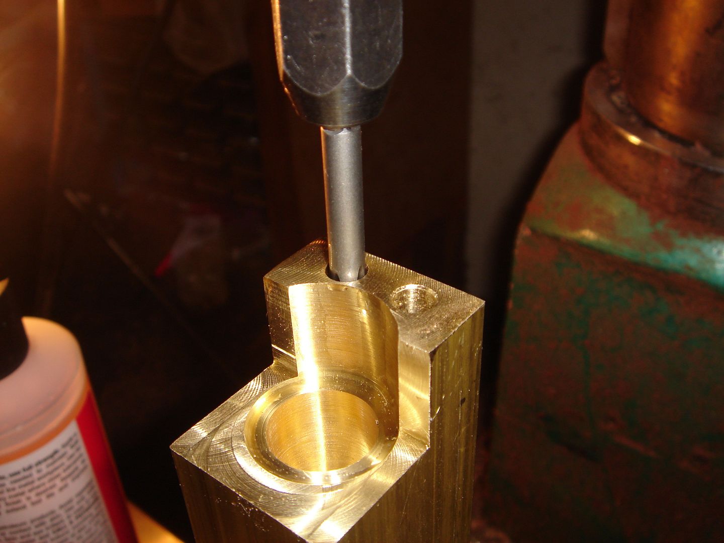

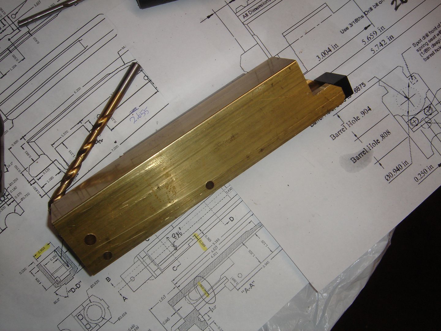

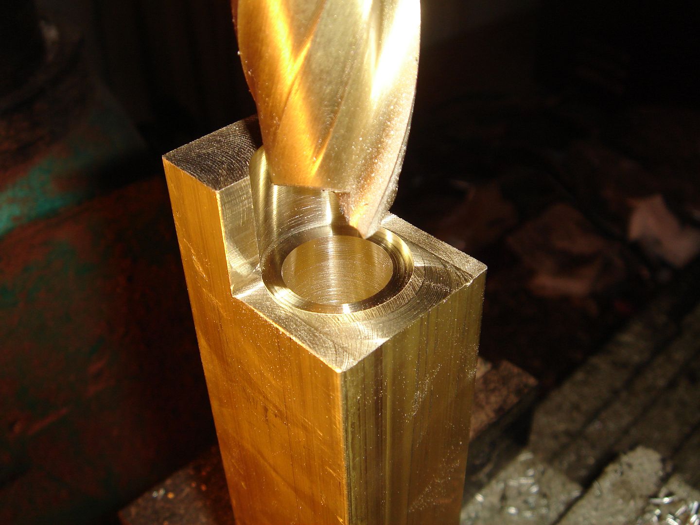

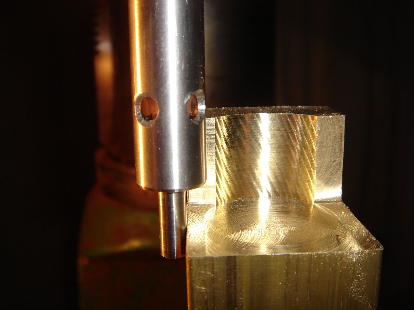

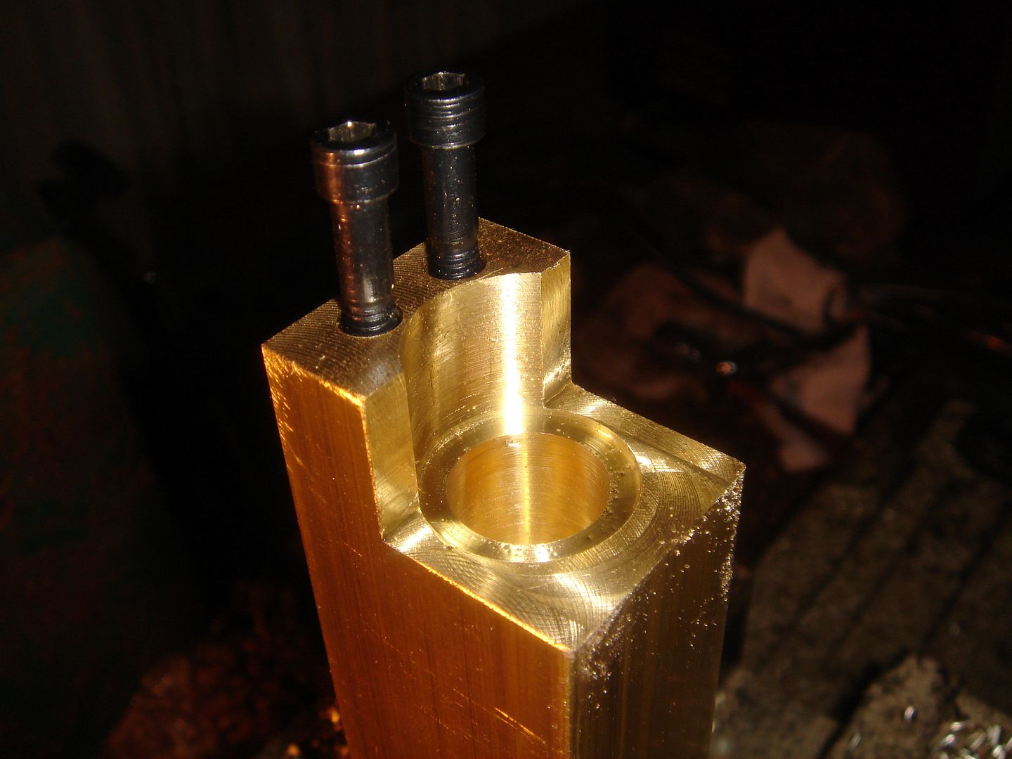

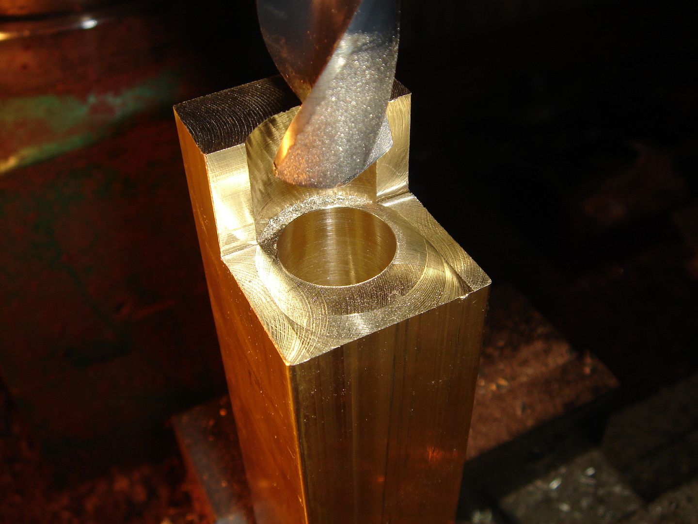

My young friend (we will can him John) came over this evening, and we started the fabrication process. First, I had him measure a receiver and look at the drawings to determine what length to rough cut the work piece. He initially thought just a line in about the right place was sufficient, but we discussed the measure-twice-and-cut-once concept, and the importance of leaving enough material to true up the piece within .001". I then scribed two Sharpie lines and told him he needed to keep the hacksaw blade kerf within the two lines. I showed him how to orient his forearm along the same plane as the desired cut, and to cut 20 strokes, check, correct, and cut 20 more strokes correcting each time until through the piece. He tended to cut to the right on the near side of the piece and to the left on the far side. He trued his stance and used his left hand to correct, finishing pretty close to the mark. I stressed that precise hand sawing is a very important skill to master.
Sorry for the poor photo:
We set the piece in the mill vise and cleaned up and trued the hand-cut end:
This is where he had a bit of trouble understanding. I tried to explain how to make the piece exactly 7.00" long by finding the edge of the piece (edge finders still puzzle him) and moving across 7.00" plus the diameter of the end mill. Some of the confusion stemmed from my use of "thousandths" and his not reading the decimal places correctly. Since we had to find the edge a number of times, he finally got the hang of it...for now. I'm guessing he'll still have trouble during our next session. Without moving the work piece, we cut it to exactly 7.000" and then started milling the front receiver extension. The extension needs to be .550" thick from the bottom of the work piece (the magazine plate will be added later), and getting a micrometer in there was a challenge. We scribed another line about .100" above the target depth and milled away the material. Once we got to within .010" of the target thickness, we came in and cut .005" at a time. He seemed very pleased when we made the final cut and the piece measured exactly .550" (reading the micrometer also proved difficult, but he'll learn) and the length was also dead on plus .005":
Setting the piece up vertically to cut the clearance trough in the extension, I showed him how to use a dial indicator to true it. He seemed to grasp the importance of that part quite well, and quickly realized that set-up time often takes longer than cutting time:
Finding the edge again, he figured out on his own how to find the dead center of the piece. We used a 1" end mill to cut the trough, about .100" from the top and down on each cut and .195" deep until we were .005" from the face of the receiver (we had left the receiver face .005 long so we could clean it up at the same time we finished the relief trough). As expected, when machining way out away from the mill vise support, as we cut the final .005" (.200" total trough depth) for the full length of the extension, we got just a bit of chatter. Then we cleaned up the last .005" off the receiver face and stopped for the night. The session took about 2 1/2 hours. We left the receiver in the mill for the next session:
Next session we will drill the barrel shank hole to a reasonable depth, cut a .040" countersink, and drill and tap the V-block screw holes without moving the work piece. Then, we'll drill and tap the stock bolt hole in the receiver extension, and drill the trigger assembly mounting holes and the bolt buffer hole before hogging out the interior of the receiver.
By the way, we're leaving enough material on the top of the receiver to allow for cutting integral scope bases, probably for Talley rings. In case anyone is wondering, I was going to make my receiver simultaneously but decided to finish his first, since he seems anxious to make progress.
I'll be out of town for about a week, so the next session and installment will have to wait until then.
Thanks for your interest.
Teddy Bear Rat
  #72
Old 02-15-2013, 08:52 AM
dufferDave
May 2012
west edge of Ft Worth (over the edge?)
1,010
While you're at it....
I don't know if you thought of this, or if you even want to, but if you are starting from scratch like this and leaving a little extra meat here and there, you might want to leave a pad at the rear edge of the receiver to add an aft anchor bolt?
You seem to be taking this other guy through machine-shop school, teaching micrometers, set-up, and even hand tool techniques. I commend you for this, for having the patience and showing the kindness to teach someone. I know this sort of thing can be trying at times because I have taught a few classes in a different hobby.
And thanks for taking the time to photograph and describe all these steps, your documentation is extremely helpful and valuable to many of us. Show us some more of that beautiful craftsmanship!

Awesome stuff TBR. Little confused on the following statement:
"I tried to explain how to make the piece exactly 7.00" long by finding the edge of the piece (edge finders still puzzle him) and moving across 7.00" plus the diameter of the end mill."
With the "wobbler" type edge finder I use in my milling work, you find the "edge" and that gives you the center of the spindle in relationship to that edge, minus the width of the edge finder itself. So move .100 (1/2 the edge finder width) toward the piece and that places the center of the spindle at the true edge, or your zero (datum) point. Then you would move the 7" but only add 1/2 the diameter of the end mill. This puts the cutting edge of the end mill at exactly the 7" point. Am I seeing this wrong or are you using a different edge finder? Not trying to nitpik sir. Just like to understand what I read and learn.
Awesome project TBR. Did the prints match up with a receiver ok or were there any major discrepancies? Thanks for sharing and your young friend should be VERY appreciative of you giving of your time and experience. A good job shop machinist can find a job anytime. And you can take a job shop machinist and make him a CNC operator MUCH easier than the other way around. Really good compensation in the field also. Wish more kids had the kind of opportunity this young man is getting. Need to put the "teach" back in teaching. GREAT job TBR, all the way around.
  #75
Old 02-15-2013, 09:44 AM
TEDDY BEAR RAT's Avatar
TEDDY BEAR RAT
Jun 2009
5,678
100% (33)
We're doing the same thing, I just omitted a few steps. I see now that it could be confusing. After we trued the hand-cut end, we actually didn't need to find the edge, since we just created it. Moving across the piece 7.000" from the end of the cut, then adding the diameter of the cutting tool was the quickest way to get there. After that, we actually used an edge finder a number of other times. I use a battery-operated edge finder that lights up when it touches the edge; it operates without the spindle rotating. Its diameter is .200", so we moved .100" to get the spindle's center line on the edge and moved the appropriate distances, allowing for half the diameter of the next cutting tool.
The drawings are very important and close to the Ruger receiver. I'm also using a milled VQ stainless receiver, which is a bit closer than the Ruger to the drawing dimensions.
Anyway, thanks for keeping me on my toes...man, you guys actually read all this stuff!
TBR
