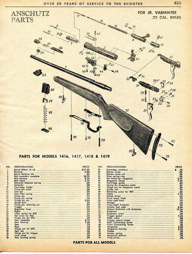

What is the basis for believing that a Junior Varminter might be pre-1958?
Photos may help identify more about the rifle in question.
In the meantime, some older ads may shed further light.
The Junior Varminter may be a name for one or more models of early Anschutz 64 action rifles advertised in the American market.
Below is an ad, from 1962 or 1963 (as claimed in the source for the ad), showing several models under the "Junior Varminter" banner.
Below is a parts list, apparently from the same time, for "Junior Varminter 22 Caliber Rifles and Carbine". It includes several different models.
