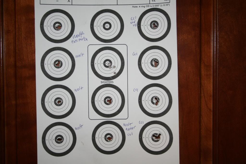

Well to all the skeptics I am another convert! I was pretty much there before having improved my Shultz & Larsen 33 dramactially using this system but my "new" 52 was not doing so well yesterday at either 50' or 25yds so I came home and put in 45 mins. with the tape. The following pic shows the results. The bottom right would be representative of the best group from Wolf yesterday. I realize the accuracy is not what a lot of you would expext at 50' and I hope to improve with practice with my new toy but the improvement is obvious!
Those groups are off the charts as far as I'm concerned. I have two Savage FV-SR's. At times I can get a .500 to .750 group, but I'm always getting fliers. I just tape bedded my Boyd's Rimfire Hunter stock and went to the range today ... I must be the worst bench rest shooter that ever lived !
I got a couple of 1 inch groups but a few 1.5's too.
I'm using the Savage magazines to load all my ammo, should I be loading them in by hand and not using the magazine ?
All screws are tight and the scopes parallax is set at 50 yds, the power set to 12x, and everything else seems fine.
On another note, the ammo is old, about 12 years, does .22 deteriorate that badly over 12 years ?
Thanks for the input guys !
