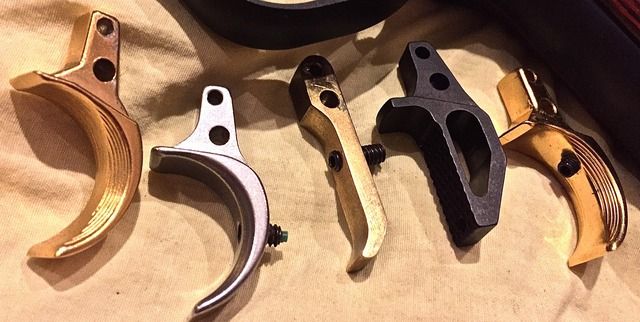

There are quite a few Buckmark Adjustable Trigger Products available now to go along with the stock unit if you do your homework and find what you need and what you can afford. It's not hard to find brand-made, professionally produced products, and homemade versions that look and function just as well.
There may be many more on the market now, but these are a few I recently found and tried.

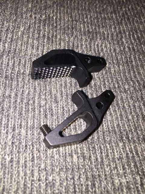

The latest player is Tandemkross' Victory, in smooth face and textured.
They are both nicely finished and come with set screws and a small allen wrench to adjust them.
The kit included easy enough instructions, and it took about 15 minutes to install and check the function, which seemed fine.
Installing and setting the over-travel screw in all of them was a super pain for my fat fingers.
But I eventually got it done. The Victory seemed to function and release the sear fine.
But every now and then during a dry firing test, it seemed not to reset properly. That could be because I had a plastic dry wall plug in the breach and it wouldn't simulate the actual firing force from a live round.
What about a home-brew product?
One of our forum members makes a very nice flat-bladed brass or aluminum unit with a set screw.
It comes with excellent instructions and even some drywall anchors for dry firing testing.
Everything fit and worked fine. But I would be a little concerned the polished brass might discolor after a while and need a little polishing.
Though aged-brass looks nice too.
And looks don't effect the actual function, which in this case seemed rock-solid.
I cannot stress enough between the install sheet, supplied allen wrench, and dry firing anchors, this was the most complete kit I've found.
It showed no machine marks, came nicely finished, and installed/worked fine.
Here's a professional gunsmith's all stainless steel trigger next to a stock Buckmark unit.
It includes a nice bit of nylon on the end of the set-screw so it wouldn't mar the finish inside the trigger well.
It felt nice with rounded edges, looks first class and feels great.
I was eagerly awaiting getting it installed to see how it worked BUT......
The pivot pin wouldn't easily go into the trigger hole...It seemed too big for the pivot hole in the trigger.
I tried up to the point I knew I shouldn't force it anymore, and it still wouldn't fit in.
But my Buckmark Trigger Pivot pin worked fine in all the others.
I spoke with the manufacturer, who told me in some cases Browning used a thicker pivot pin that needed a little bit larger pivot hole in the trigger. He offered to swap out the one that didn't fit with one reamed a little bigger. It installed fine, but wouldn't release the sear. I took off the slide and barrel and everything seemed to be in place and working as expected. I re-installed an adjustable trigger that worked before, and it worked just fine.
Very nicely made stainless steel trigger, but this amateur 'Smith couldn't get it to work and the others installed fine. The maker says some newer Buckmarks are very sensitive how deep the disconnector pin is set, and the depth of the pin needs to be carefully adjusted to function properly.

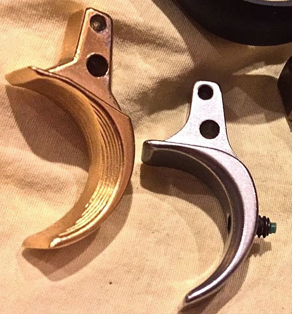

What about the OEM Buckmark Adjustable trigger seen at the right side of the group?
Typical Browning quality, nice gold anodizing to match the stock unit, but casting marks were visible.
You'd think going with a stock Buckmark Item would almost guarantee a perfect fit, but you'd be wrong.
My 3-4 year old Buckmark Hunter took the install just fine....pins fit, no hiccups at all.
So what's the problem?
It wouldn't fire.
Specifically, the trigger wouldn't move rearward enough to release the sear.
Even with the set-screw removed, it wouldn't travel back enough to fire.
I believe the back of the trigger is too fat to swing back enough even with the screw completely backed out.
I could "bubba" it and start dremeling the metal in the back to make it a little thinner, but that's not what I want to do on my gun.
To double check everything I re-installed the stock Buckmark trigger and it worked fine.
