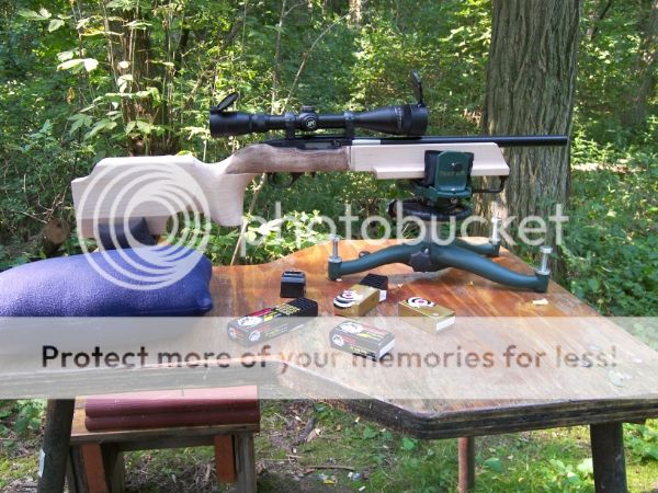

I made mine a little too tall, I think, especially considering the uphill shooting angle on my range. The difficulty is that once it's glued in place it's very difficult to recut and still keep parallel to the bore. I don't have a mill with a cross-slide vise to get that done precisely. Still trying to figure out a way to cut it down a bit without screwing everything up. (picture head-scratching)
Not sure if you've followed my build thread in the stocks section. No recent posts because of, well, the head-scratching.
After looking at my build mockup early on, and thinking it 'looked' good aesthetically I went ahead and glued it before really trying to shoot it. Now, it feels a little too tall.
Then I start reading Blacknboostins' thread here about bench tips and techniques and the wealth of information therein. I'm worrying about the spokes on the wheels of my buggy while the F1 cars are going by! LOL
Anyway, what an amazing and fun way to do a 'build' project without getting into the inletting.
Based on my limited experience in this, use screws, tape and whatnot to get it to shoot and feel right as best you can before you commit. I knew that and still got anxious and made the early jump.
Here's a pic of mine:
[IMG][/IMG]
I carved a small thumbrest recently and shot a bit with it, but the mosquitoes on my range kept trying to carry me away, so no great cards to post.
BTW, I never thought about actual dimensions on this, just used a Boyd's Tacticool as a sort of pattern while looking at several images of McMillan and B&C target type stocks. I'd like to see some pics of what you're doing with this.
