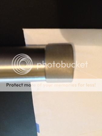

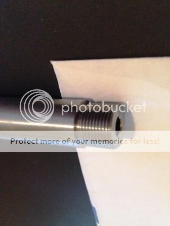

Here are my friends fine craftsmanship skills once again(Tornado Technologies). A 10/22 takedown barrel, cut, thread, re-crowned and a knurled stainless thread protector fitted. I paid $109.00 + optional $17.99 for the stainless thread protector.
[IMG][/IMG]
[IMG][/IMG]
[IMG][/IMG]
