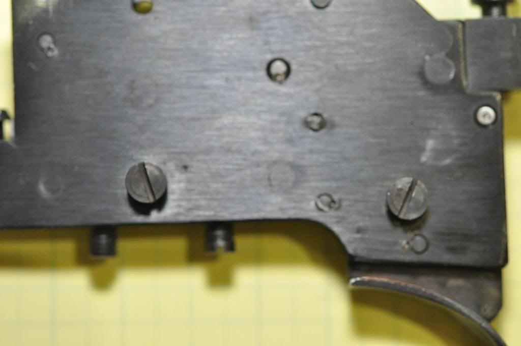

Win 52 Repo (Japan)
Are the any breakdown instructions available for these triggers? I know they have lawyer triggers, but I still would like to know how they work and the best way to deal with them.
Everything seems similar except for the lack of a sear adjustment screw. There is also a roll pin the prevents adjusting below the lawyer recommended trigger pull. The sear transfer bar is the same as the Factory 52 C,D & E. Just looking at it, something looks different, but it must be totally broken down to see it.

Thanks for the photo, Fred J.
I can tell you with the lawyer pin removed, it is possible to turn the pull weight screw down far enough that the sear will not catch for cocking on the bottom of the bolt.
Seems the only quick remedy for this situation is a lighter tension spring for the pull weight screw....
Has anyone been brave enough to tear down one of the repro triggers themselves?
