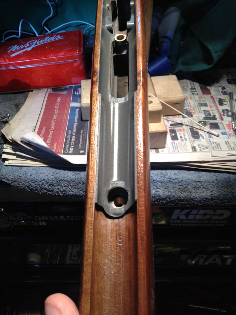

Hoping to improve groups by glass bedding. My plan is to full bed action and 1.5” of barrel near chamber. I’ve been reading about some of you guys doing this to your 455’s and 452’s. Thanks for sharing your info! This will be my first bedding job. I want to free float barrel and then play with shims under barrel to see if accuracy improves more. If I tape the barrel to make sure it’s free floated, won’t I be lifting the action off the front pillar? I don’t want that do I? Also what would you all recommend when it comes to that floating recoil lug as far as bedding it goes? Any help much appreciated.

Stock prepped and ready for epoxy! Just waiting on the recoil lug I lost. Let me know if you guys see something wrong with this.

If your pillars were set correctly your barrel should be centered. If you are taping the barrel and it is moving the barrel and action then you won't have a stress free bedding job, it will be putting pressure against the pillers sideways. I hope I'm clear, the time to use tape to center the barrel would have been when epoxying the pillers in but you are past that.
Looks like you have prepped well, probably a little excessive but that is normal on your first few bedding jobs. Good job and it gets easier as you do more, just make sure you get all metal prepped with release agent. Good luck

Iím not familiar with the position of the barrel lug in the 457... but I bedded a 452 the way you have yours mapped out and it shot
like crap. I stripped out the bedding & started over, bedded the receiver and entire barrel channel up to & including the barrel lug, with a custom pillar for the rear action screw & brass escutcheon for the barrel lug. I also installed a tiny #6 Allen plug screw inside the barrel lug to lock it in place. Results were excellent.
Bedding compound was Devcon 10110 Plastic Steel putty, release agent Kiwi neutral shoe polish.

that tape is only there to center the barrel in the channel. It should not be used thick enough to lift the action from the pillars.

Grg, the pillars were set at the cz factory. I have no idea if they are centered. I guess I just assumed they were. They are some kind of dense composite material.

Hi DrGunner. Yes, I’m very familiar with your bedding job post. I’ve read it and reread it and enlarged photos. Your post was the google search that brought me to rimfire central. Most informative. Thank you.
Cz 457 recoil lug is a floating square of metal that sits back at the tang. I’m not sure what it does because it’s a loose fit in the slot that it mates to in the action and a sloppy fit in the stock.
Looks to me like your rifles front action screw is up in the barrel channel? Could that be why your rifle didn’t respond well till you bedded clear up to it? (If I’m understanding what you wrote).
Why did you have remove bedding material? Couldn’t you just add more to go further up the barrel?

Rms65 I see what you mean about the tape. I could tell when I didn’t have enough wraps of tape because I could feel the barrel come down and tang go up. So I just checked after every wrap once I was close and made sure to not be bringing barrel up and tang down.
Its pretty simple to me now but when I keep doing this job in my head through each step, that step kept tripping me up.
