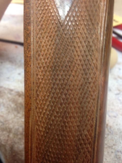

These pics are from a CZ 452 stock I re-cut the checkering on. It was first done by machine, which has the advantage of laying down lines that are DEADNUTS straight and true but the disadvantage of creating diamonds that are dull and rough. Plus the borders were shallow and didn't follow the diamond pattern.
Either way, after re-cutting each line with a single line cutter and and short V-cutter there was a noticeable improvement both aesthetically and functionally with really sharp diamonds and not just the illusion.
Before:
Not the best pic, but you can see the diamonds in the pattern look perfectly aligned but not well defined. Also you can't really see any of the wood grain through the checkering- something I've learned is the sign of good clean sharp cut checkering.
During:
After:
